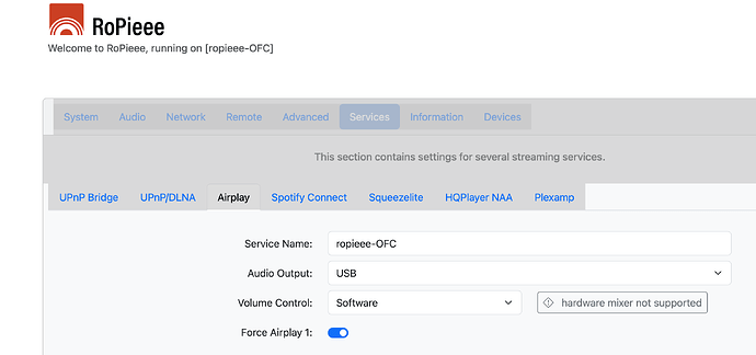

Ok… as you are using software volume control: are you sure that’s not the problem?
The Hardware Volume Control option is greyed out (Not available). I even tried the NONE volume control and that did not make a difference either.
Any idea of what else can I try? Í´d appreciate the feedback.
