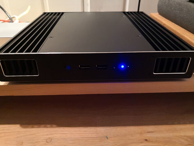

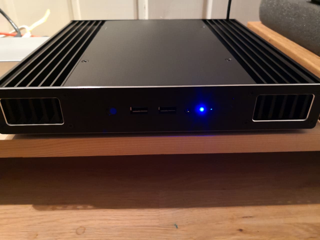

Core transplanted :+1:
Took about 45 mins including disassembly of NUC.
Trickiest part was getting motherboard out of the NUC without thinking it was going to snap.
