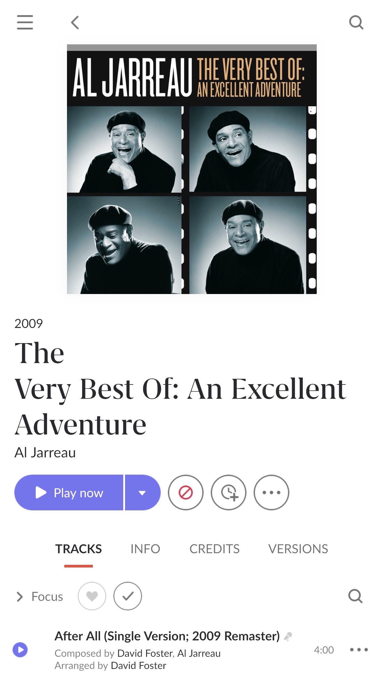

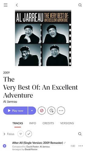

Can you post screenshots of the Roon application when you are playing a track from this album…
  1. The album page

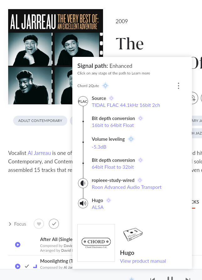

From that image, it looks like you are playing the MQA version from Tidal …
Can you post a screenshot of Roon’s signal path.

From the signal path I can that Sorgente track is not MQA encoded (or at least not properly).
So it should not matter if the MQA decoder on Roon is enabled or not.
I think you have your answer, listen to Qobuz version.

No MQA source shown in the signal path, so I’m guessing the MQA signalling may be corrupt.
