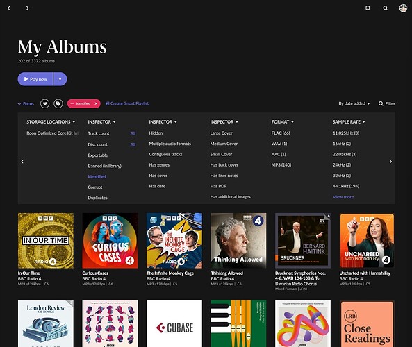

A first step might be to ask Roon to display all the albums that it has not been able to identify. Go to the Album browser, and use the Focus function to display all the albums that it has been able to identify, like so:
Then click on the purple “Identified” button to negate it, that is, ask Roon to display all the albums that it has NOT been able to identify, like so:
These will be albums where Roon has used the metadata in the files to create the album entry. Sometimes, metadata can lead Roon astray, it’s always a good idea to follow what Roon expects:
The Focus function in the Album browser allows you to select all albums by a composer, if that’s your preferred way of searching your collection.

You mean the Focus in the Album browser? Then something odd is going on in your library. It works properly here:
