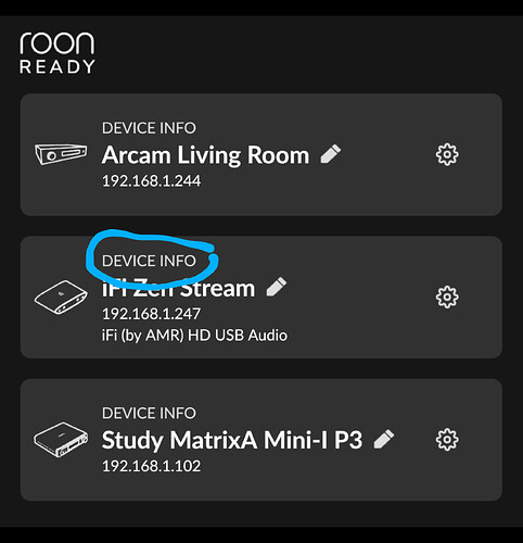

I can’t find that setting. The settings panel shows that the USB DAC is recognized, but the device info on the main Audio panel shows “SPDIF” as the output for the Zen Stream. If I switch the screw in the back to AIO, the DAC is recognized. Both Roon and Zen Stream have the latest software releases.

Fernando I kept these screenshots from last year and just managed to find them. In settings->Audio click on the device info text, it’s a button that is badly layed out.
That will launch a an information popup that gives you a config window to change the Zen settings.
You can then change the output from here
Hopefully this helps

Thanks for all the advice! I do have the latest version. That “DEVICE INFO” button escaped me, it looked like a label for the information below. Finally got to the config page appears, it’s a bit broken in that it silently fails to switch to my USB DAC unless DSD is disabled – I guess that makes sense since this DAC does not accept DSD, but at least a warning would have been nice.
