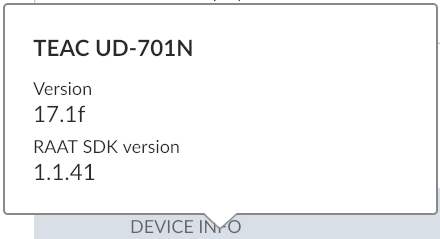

And I also noticed that my TEAC 701 has a newer version of the RAAT SDK.
teac-raat-v
iFi Zen’s version is 1.1.38
same version here with the ZS, but no issues with Roon playback
