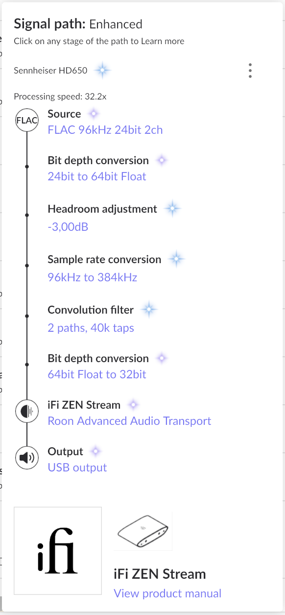

Roon Server upsamples and pushes a lot of traffic

So I have spent the last hour and a half listening to music to my headphones using the Stream and the original Zen DAC.
And after about 15 to 20 minutes there started an occasional skip in the music and even though it is about one skip per track it’s really annoying.
I might have to follow the roll back instructions myself if I am going to use this regularly. Maybe I should try HQPlayer first and see if it only happens in Roon
