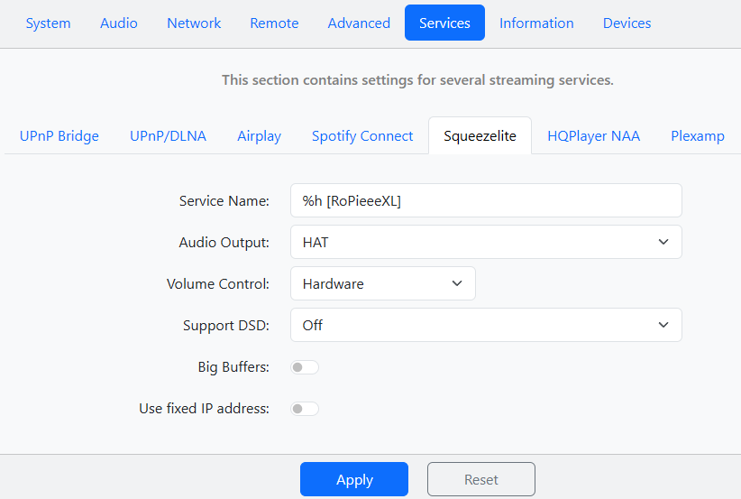

I think so. There are not many options to get wrong.
It is set to “Hardware”, exactly the same as the other Ropieee zone with the older original “BOSS” DAC HAT.
