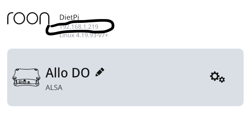

Go to Roon Settings > About to determine the IP address. It’ll be listed under Roon Brdige. Then type http://<IP address> in your browser.

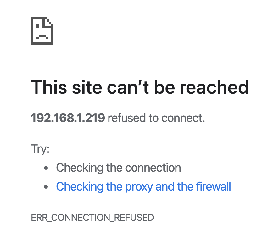

I have done as you’ve suggested. Usually I was getting the IP address from my router’s phone app, but I had also got the same Allo IP address from the Roon settings. But I’ve just done it again, and same results - can’t access GUI.
Safari says can’t open the server and Chromecast says the IP address (of the Allo DietPi) refused to open.
,…went to Roon Settings and found the IP address listed in Roon for the Allo under Roon > Settings > Audio.
So it didn’t work, but your suggestion was welcome and helpful. It tells me that what I was doing should indeed work - and its helpful to know that.
I entered the IP address ("http:// in Safari and Chromecast browser address bar.
