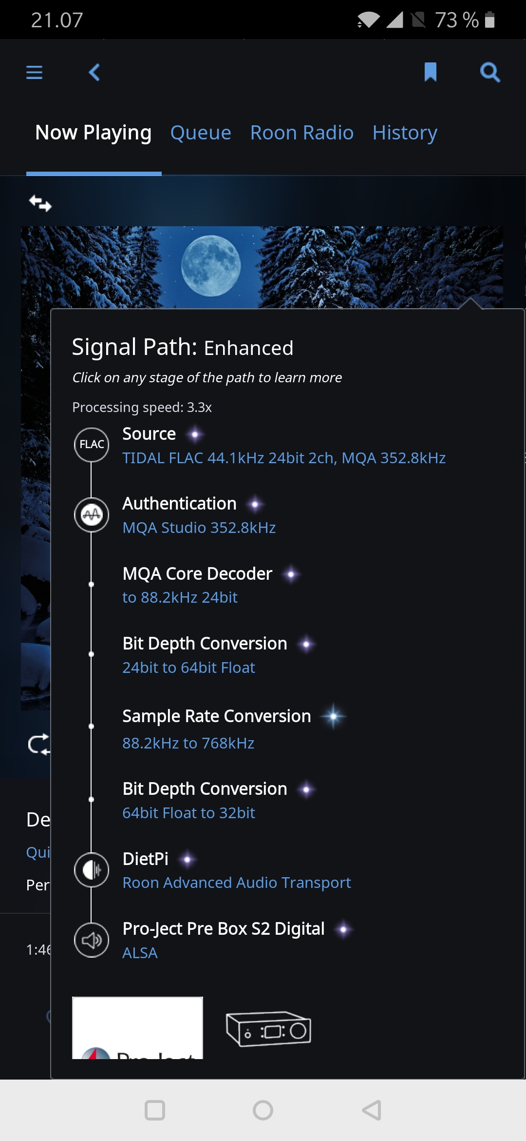

Ok…spent some hours to get this to work…now, im in heaven…litteraly
ROON ROCK>ALLO USBridge>Project Pre DAC…all via ethernet
Se pic…deff recommended
