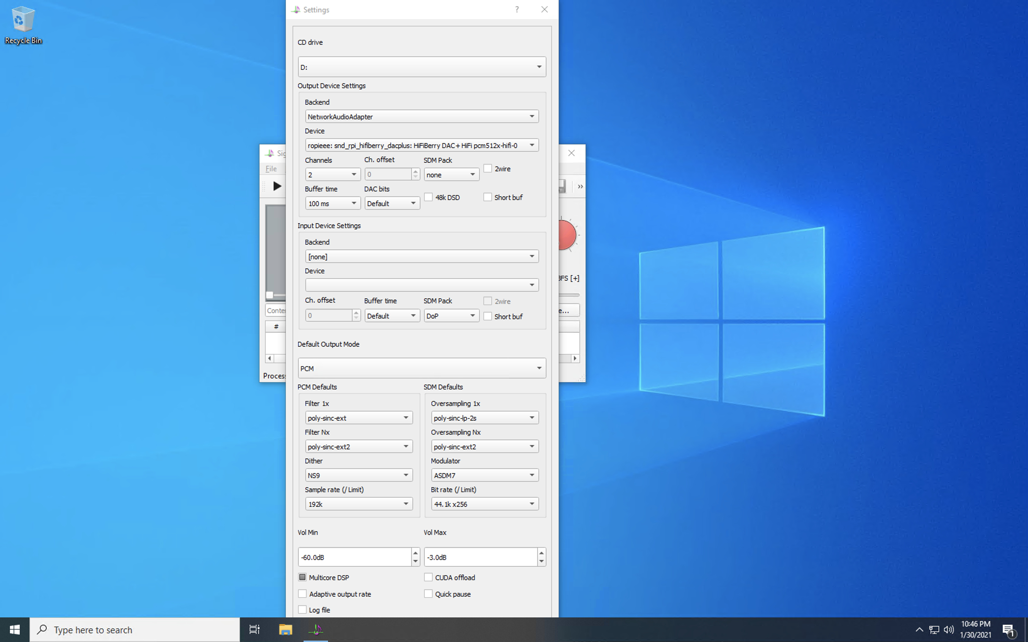

Here’s the relevant information, @dabassgoesboomboom. With the volume in Roon all the way up, as pictured, it’s barely audible. I should add that this is the case when I output directly from HQ Player as well.
I don’t use HQPlayer Desktop version (I used Embedded version) but in the background of your screenshot I see the volume knob is red. That doesn’t look normal.
Can you show that screen?
@dabassgoesboomboom it isn’t always red; that’s one of the things I’m trying to pin down.

@dabassgoesboomboom Force Volume wasn’t touched touched since the re-flashing last week and is still off now. Switching to 96kHz made no difference; attached are the screenshots.
All settings look very good.
