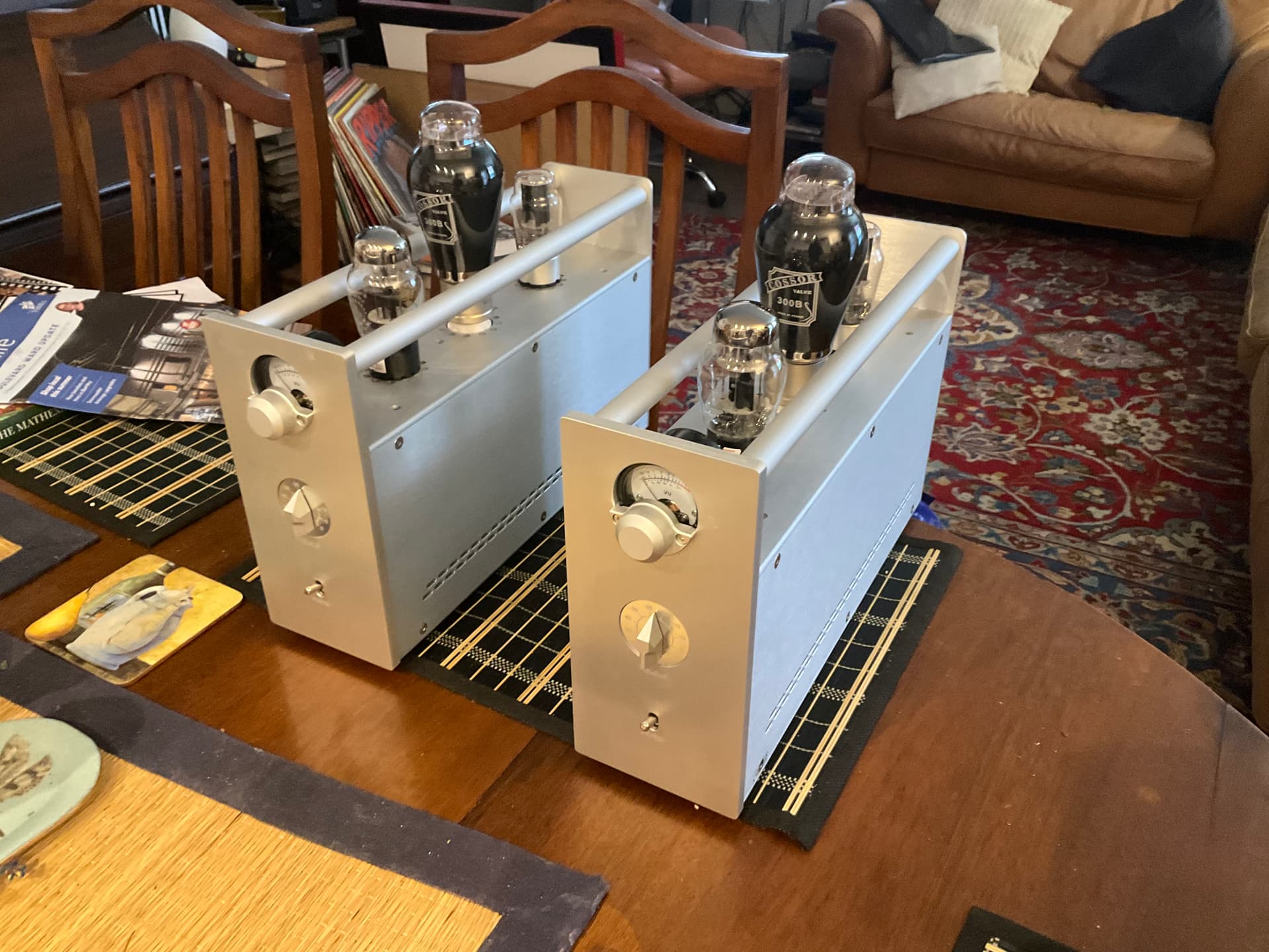

My daughter, Genevieve, enjoys music and audio so some time ago I gave her a pair of Aurum Cantus speakers with a very nice ribbon tweeter.
These have separate terminals on the back, suitable for biwiring or passive biamping. Initially I had also given her some generic Chi-Fi Class D monoblock power amps, but I’d always kept an eye out for something better.
So I was interested to see some BrzHiFi Audio 300B monoblocks available for a very attractive price (no tubes). Or, if I really wanted to pay more, I could leap at the $3,500 USD offer of the same amps with Altec Lansing badges.

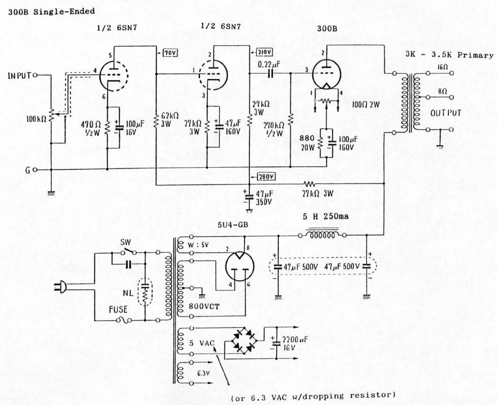

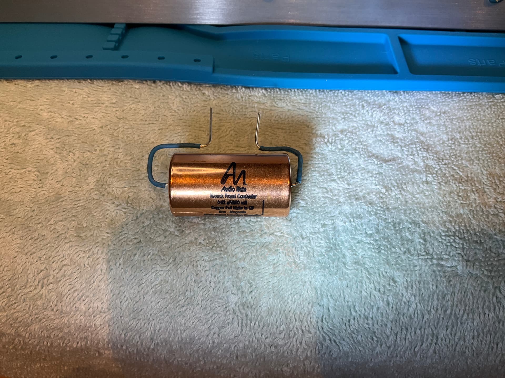

I learned about these amps reading this diyAudio thread and saw that the OP had substituted an Audio Note copper foil/mylar capacitor for the supplied WIMA type as coupling capacitor to good effect.
The thread also contained a useful schematic:

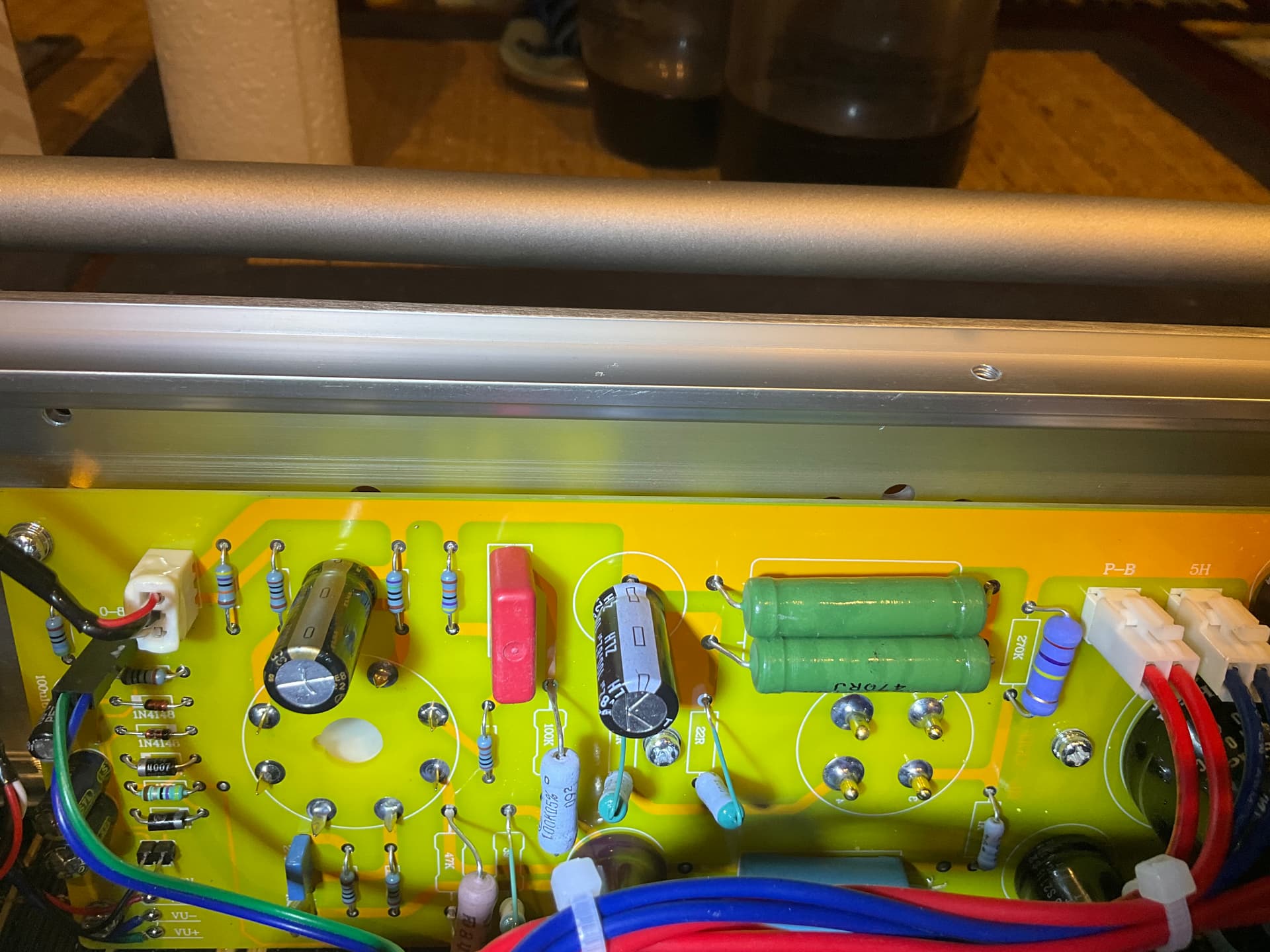

This set out the gist of the circuit, but in my case the coupling cap had been downgraded from 0.22uF to 0.1uF.
So I ordered a pair with a view to substituting in the AN cap and passive biamping the speakers.

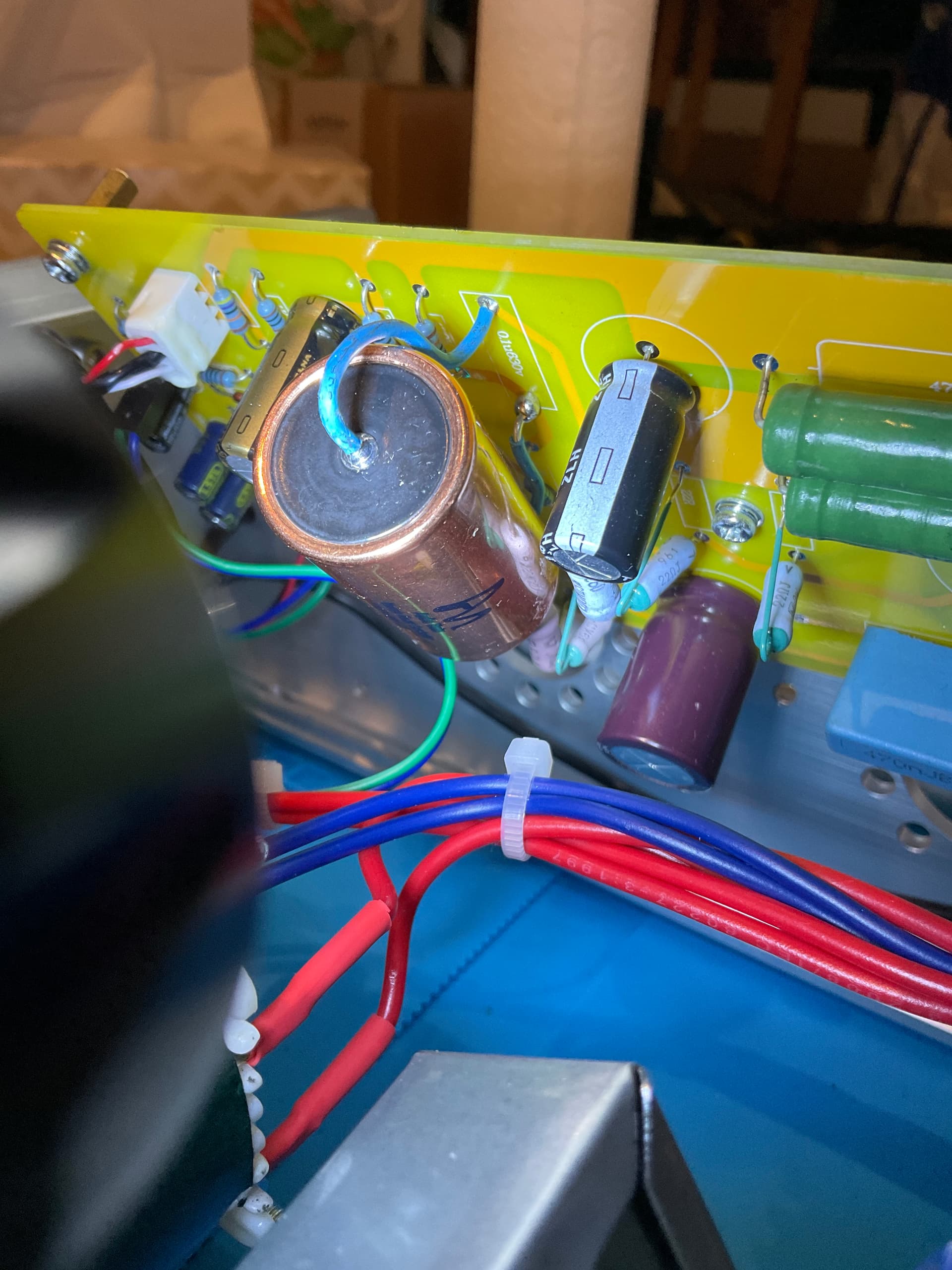

I broke out the soldering iron and was able to identify and substitute the coupling cap without too much drama.
I reverted to the 0.22uF capacitance for the AN cap, which would lower the ‘knee’ of the bass response (that I never thought of as significant because of the intended biamping).
With the modifications complete I put in the tubes (Psvane Cossor 300B, Psvane UK series 6SN7, Shanguang 574P rectifiers) and hooked it all up in the guest bedroom.
I thought I would break them in full spectrum and then biamp later. The speakers crossover at 2.2kHz.
Well, I love how they sound so much that I’ve abandoned the planned biamping. Combined with an SVS Classic 1000 sub taking over at 120 Hz these little 8 watt 300B’s were plenty loud enough for recreational listening in a medium room. And the mids were too sweet to go back to the Class Ds.
The other gear pictured is a Doge 8 CD player on top, my old Holo Audio Spring I and a VTL Maximal preamp (2 x ECC801s Telefunken). Using a Chromecast Audio for streaming to the DAC through 48k Toslink. This will be replaced by a Holo Audio Red in due course.
The output terminals are very busy, being biwired with spades to the speakers and a hi-level input to the sub from banana plugs. I didn’t get a biwired harness, so it’s two sets of spades and a banana plug on each terminal. Ugly and awkward, but doable. The speakers are 8 ohm and the hi level connection to the sub draws virtually no current.
Good fun, inexpensive and a nice upgrade for Genevieve.
