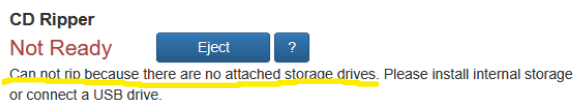

Did you try and insert an audio CD into the drive to see if the ripping starts?
Where is Roon OS supposed to store the tracks?
Note: Only the (additional) internal drive and USB-Disks are supported according to the manual you already know about. Without a suitable storage location the built-in CD ripper might not work.
Added later
Just figured out how to get from the broken symbol in your post to the attached file:
You even underlined the reason why you can’t rip – and it has nothing to do with the CD drive (so far). Please add suitable storage space to your Proxmox VM and then try again.
PS: The consensus here on the forum seems to be to avoid the built-in simplified CD ripper and use your PC/Mac/laptop instead with a good ripping tool and metadata writer before you copy the files somewhere where Roon can see them. Just FYI.

Passthrough to the VM I have just tried and a have still added the superdrive without errors, but it is not recognized by roon. Also the usb drive (usb stick) attached to proxmox does not appear, because I cannot mount it via prompt at roon installation
It is, that is why “CD Ripper” shows for you on the configuration page.
That is your issue as the “CD Ripper” will not work without a location to rip to (storage to create files). If you can’t use USB storage, maybe just add a second HDD for that purpose to the VM?
that’s fine, thank you very much for your advice belonging the storage!
I should read the underlined text in detail next time
By the way…CD-Ripper is “green” now. I have mounted the usb-stick directly in PVE an after that I passthrough the device, that works.
