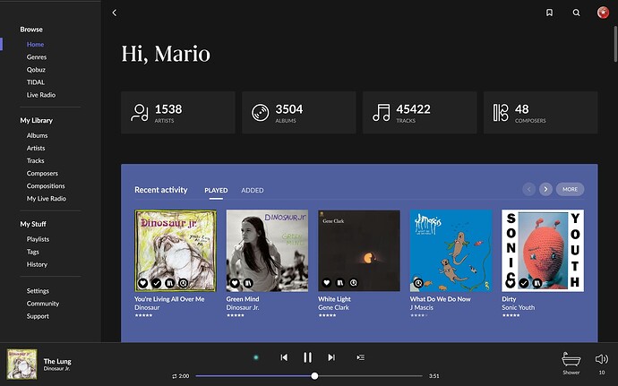

It’s confusing :slight_smile: but seems so. The first zone playing (in Roon) was updated fine in Recently Played in both Roon and in ARC, but not the parallel second zone (which appeared much later in Roon but not yet in ARC). And the order in Roon > Recent > More is still messed up with regard to the Clark and Dino play.
@Ivan - Edit: And now a second (queued) album (Dinosaur Jr - You’re Living All Over Me) continues to play in what originally had been the second zone (Shower):
And while I was writing this and track #3 was playing, it had not appeared in Recently Playing in Roon, but now when I looked it had done so apparently by track #4 (Lung)
But still none of it in ARC:

Nothing seems to sync them in my case. Today in the morning I moved the Shower zone (still with the Dino Jr queue) to the Naim zone and continued it playing there.
Now I first restarted ARC and then force synced it (while on 5G though), and it’s still not updated
Edit: Same on the office wifi, which allows ARC connection to my home server via the open port
@ivan After a bit more playing around, AFAICT the Recently Played updates immediately both in Roon and in ARC when I play something only in one Roon zone, and it does not matter which one, but if I play concurrently in two zones, it seems to get out of whack.
