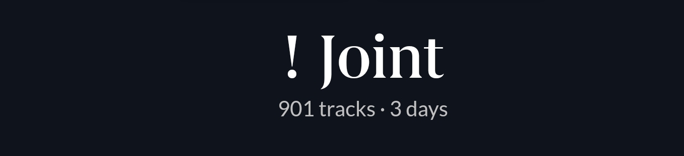

Any long playlist. They load instantly in standalone arc but not in AA. What I haven’t tried is loading from recently played, I’ll try that at some point.
Got it, thanks! Could you, please, also clarify what you consider a long playlist? :slight_smile:
