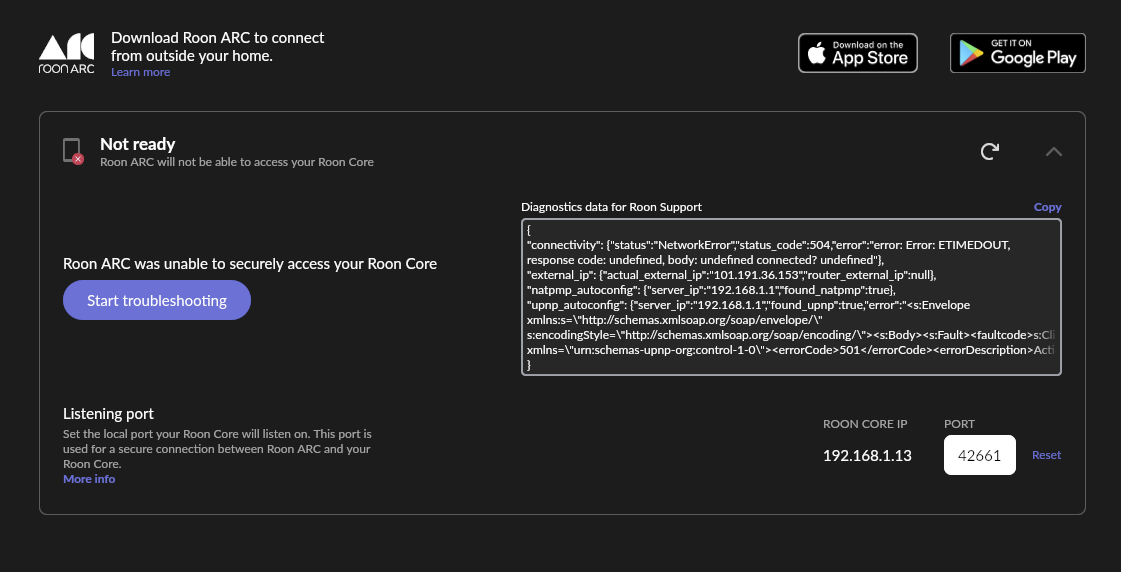

ARC app can’t connect to roon core. Orbi router has uPnP enabled.
“connectivity”: {“status”:“NetworkError”,“status_code”:504,“error”:“error: Error: ETIMEDOUT, response code: undefined, body: undefined connected? undefined”},
“external_ip”: {“actual_external_ip”:“xxxx”,“router_external_ip”:null},
“natpmp_autoconfig”: {“server_ip”:“192.168.1.1”,“found_natpmp”:true},
“upnp_autoconfig”: {“status”:“NotFound”}

You may need to manually configure your router port forwarding.

Error message has changed.Arc seems to be working on my home local network. Not working away from home.
That’s why you need to do the port forwarding.
Had same error: Allow Port forwarding or allow “automatic port setting for device” in router, saved it for me!

Same issue for me. UPNP is working just fine on my router, my Plex server uses it.
Here’s the error I get, which I think may be the same as the above;
“connectivity”: {“status”:“NetworkTimeout”,“status_code”:998,“error”:“”},
“external_ip”: {“actual_external_ip”:“x.x.x.x”,“router_external_ip”:null},

Can someone help me here. I’ve tried to set up port forwarding on my orbi router. I used the IP for the roon core as the internal ip address and selected the port 55000. Also TCP ticked.
This still doesn’t work.
Now I’m thinking I may need to change the port forwarding on the modem/router the orbi is connected to. This sort of makes sense as the service providers modem/ router is upstream to the orbi.
I don’t know why this is so complicated. I have a fairly average setup here.

I didn’t succeed in getting UPNP to work, so I set it up manually. In my routers configuration I used MAC address reservation to give my Roon Server a fixed IP address & set up port forwarding to it’s IP address using the port number that my Roon server wanted to use. It’s just a little bit more work than using UPNP, (if it works).
I haven’t tested it outside my house yet, I will later today.
I have the same router and I’m not getting a connection.
I have enabled upnp and done manual port forwarding.
Still getting an error message.
“upnp_autoconfig”: {“server_ip”:“192.168.1.1”,“found_upnp”:true,“error”:“<s:Envelope xmlns:s="http://schemas.xmlsoap.org/soap/envelope/\” s:encodingStyle="http://schemas.xmlsoap.org/soap/encoding/\“><s:Body><s:Fault>s:ClientUPnPError<UPnPError xmlns="urn:schemas-upnp-org:control-1-0">501ActionFailed</s:Fault></s:Body></s:Envelope>”}
I’ve organized port forwarding and uPnP on my router as best as I can understand from roon’s info ,( never having any experience with this side of things). Still no result.:slightly_frowning_face: I’m hoping support will chime in soon.

Here is my latest fail report after trying various setting changes,(port forwarding, upnp checking, LAN address reservation for Nucleus). Still waiting for support assistance. @support
