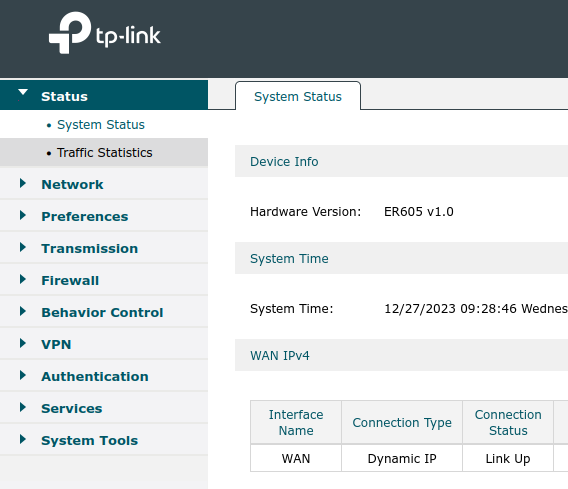

The router that is connected to the internet will have some kind of status page on its web admin interface where it shows its external (internet) IP address

The status page is usually the first menu item on the left. For example: System Status.

If you could confirm the WAN IP on the Archer, this would help to confirm if carrier-grade NAT (GGNAT) is used. If this is the situation, Roon will not work unless you ask your ISP for a fixed IP address to enable port forwarding.
I think tht the IP you asking is 100.80.xxx.yyy but accordin to the TP-LINK.COM it is not a true external IP, this IP is given by provider. Am I understood you right that in this case the only solution is to request provider for static IP?
