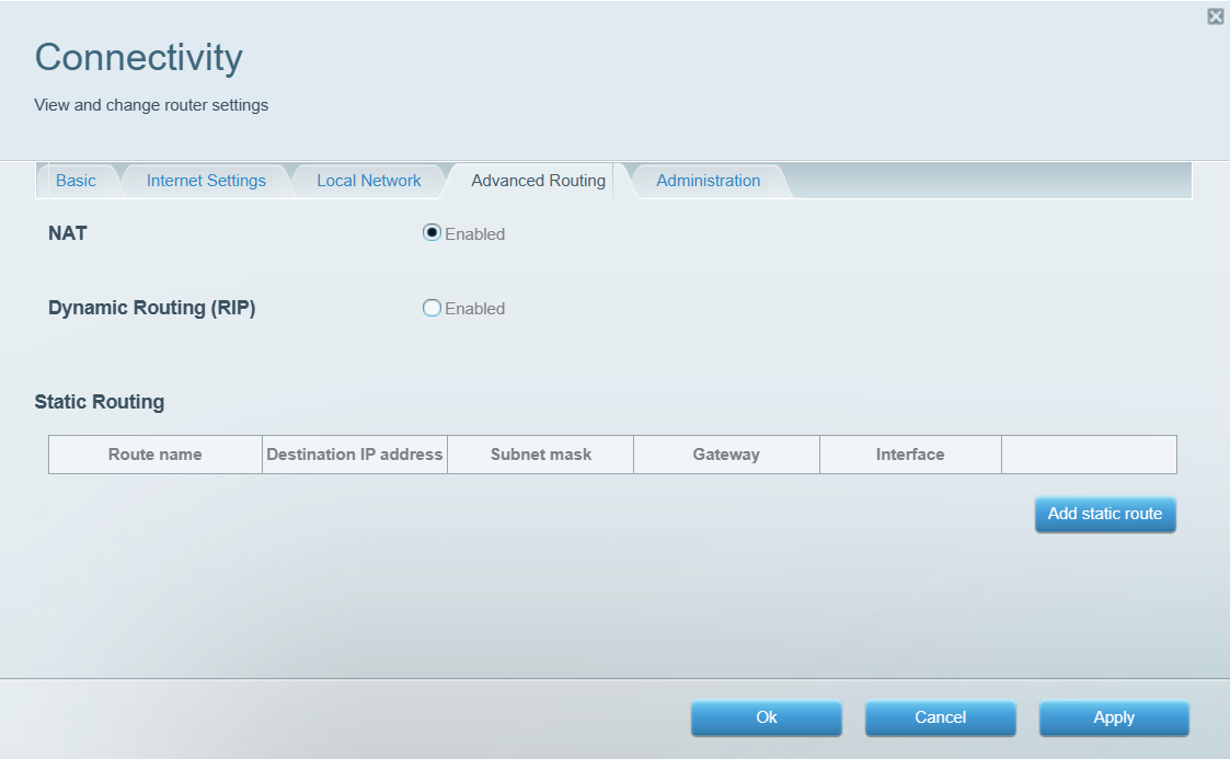

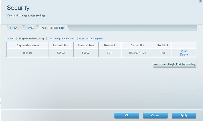

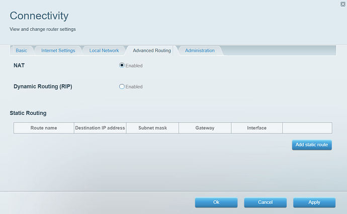

Hi Connor, thanks for the reply. Yes I am still unable to connect to ARC. Let me try and add a firewall as suggested in your link, will share feedback.
I have enabled UPnP in my router. I do not have a managed switch, its an unmanaged one from Netgear. GS116LP 16-port switch
problem still persists
“ipv4_connectivity”: {“status”:“NetworkError”,“status_code”:504,“error”:“error: Error: ETIMEDOUT, response code: undefined, body: undefined connected? undefined”},
“external_ip”: {“actual_external_ip”:“94.aaa.bbb.ccc”,“actual_external_ipv6”:“null”,“router_external_ip”:“null”},
“upnp_autoconfig”: {“status”:“NotFound”}
I’ve had to manually setup a forwarding rule in both my routers to get ARC to work.
My connection is as follows
Ziggo Mediabox (ISP router) → Ethernet → ASUS router (my own) → Ethernet → Lenovo laptop running my Roon Core.
This is a screenshot of my ASUS’s forwarding rule.
The local IP is the IP address of my Roon Core, the port number is what Roon uses. Both are listen in the ARC setup section of the Roon settings. Protocol is TCP. Source IP always has to be empty.
I’ve had to add a similar rule to my Ziggo router. With the local IP being the IP address the Ziggo router assigns to my ASUS router.
My guess is you’ll need to add a similar rule in your router to get ARC to work.
wow, thanks so much @SandsOfArrakis, the trick worked.
