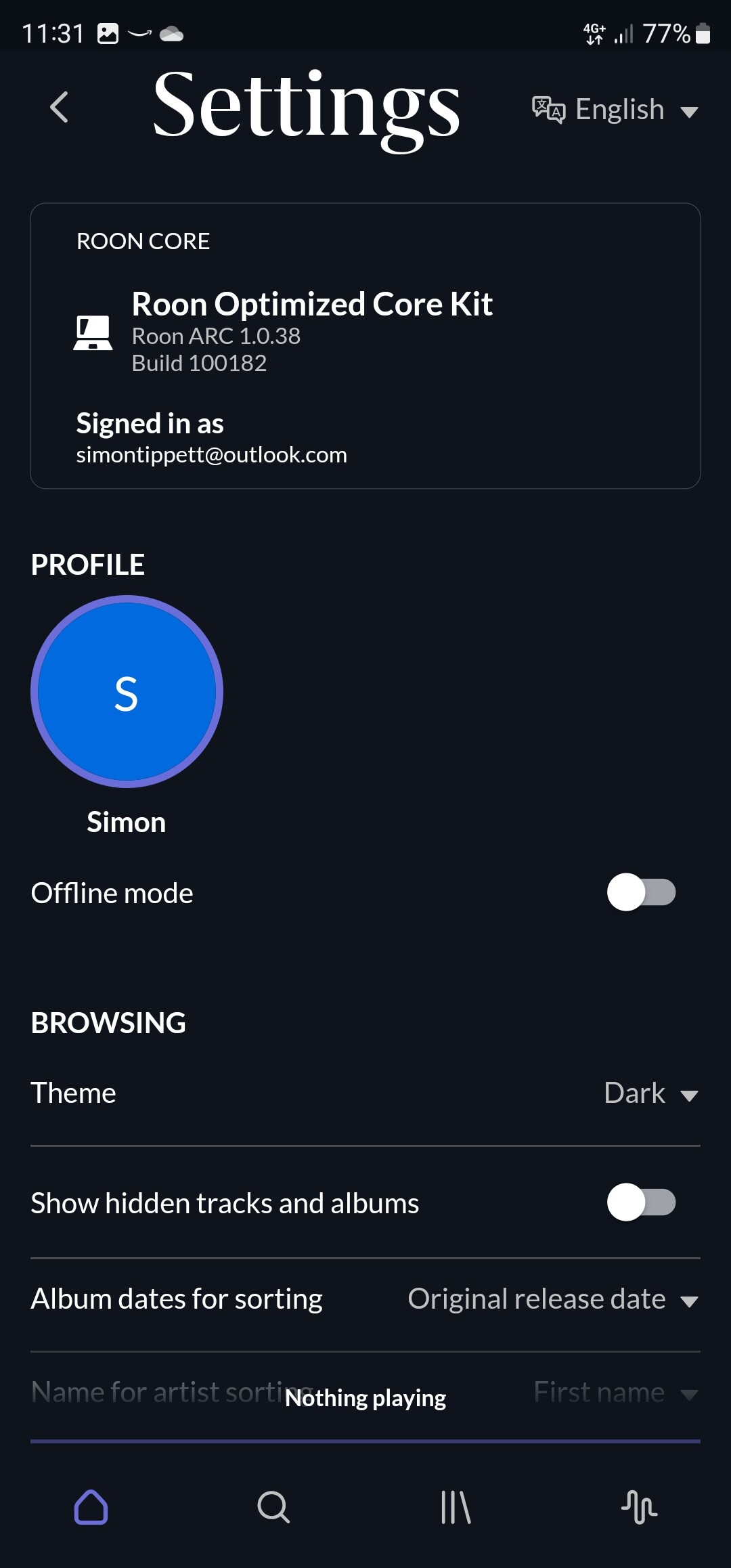

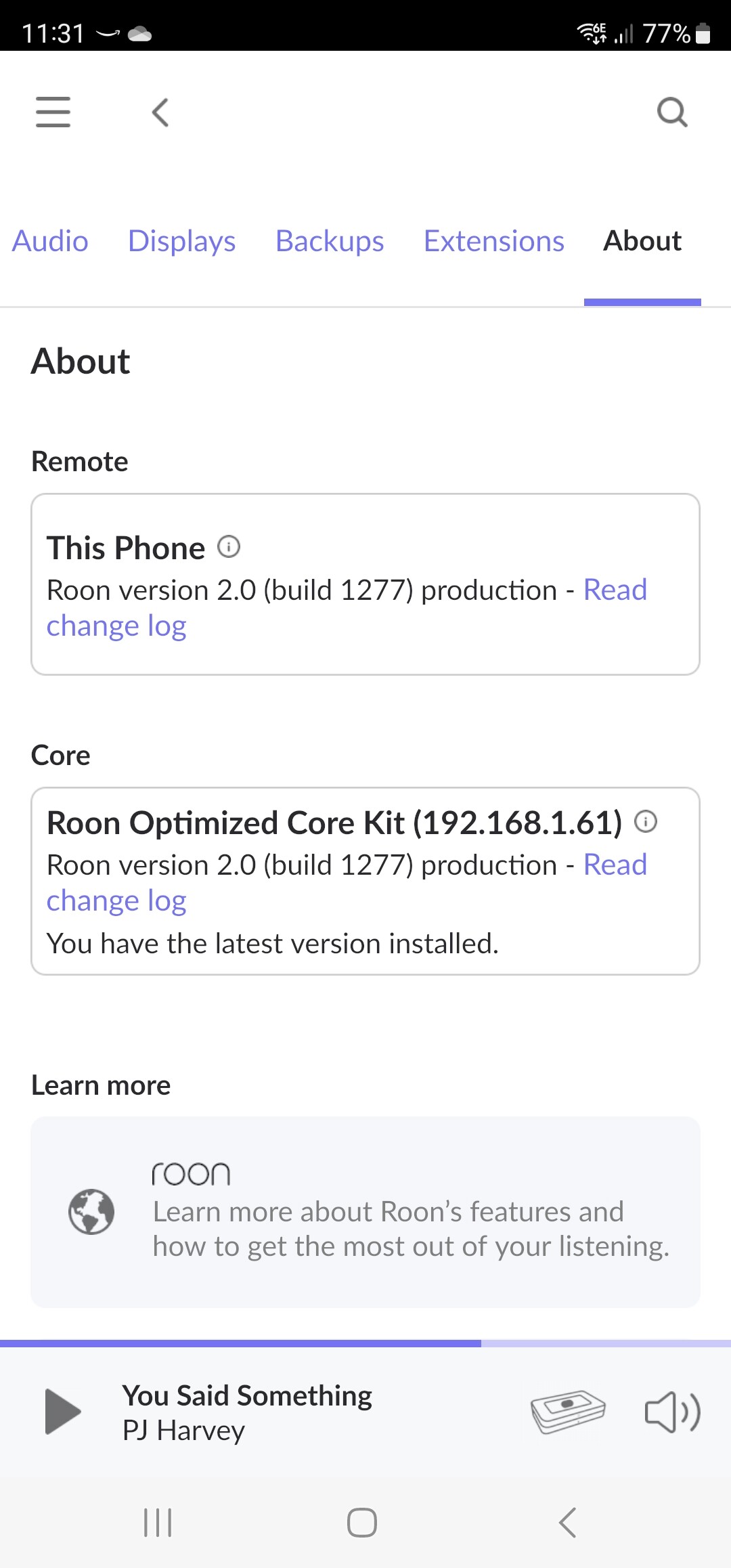

Here are the versions but I’ve just about given up… I would have given up if I didn’t have a lifetime subscription
I have uninstalled and re-installed everything and still getting the green light from Roon Arc settings but have now come to a complete standstill and nothing I can do will make it work…
You probably want to remove your email address from that screenshot
I guess so… Maybe someone might email me an answer…
Is there a proper support function at Roon somewhere? I need some technical help or my money back really…
