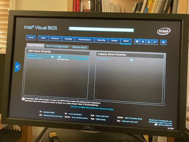

Would you kindly provide the photo of the Boot configuration in the BIOS settings, and what do you see on the step when you choose the drive to install the Roon OS?

This is configured as per NUC install guide
I got a choice to install new or recover previous ROCK
Re the drive choices, it identified the SSD correctly, then I just got 1/1 so no choices.
Confirm the choices, then message ‘Preparing disk’, ERROR etc
Exactly as in BlackJack’s link above
The screen photo is not very clear, but it looks to me as though you have Legacy Boot checked as well as UEFI boot - you should not have Legacy Boot enabled…

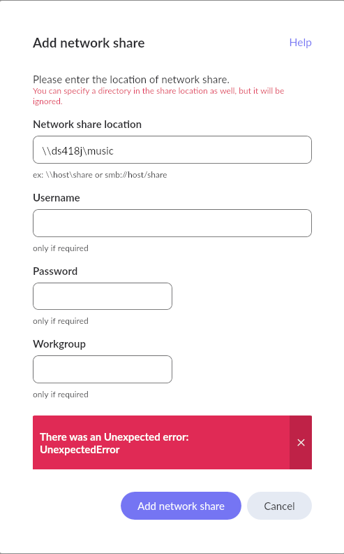

Using a windows Roon client I switched to the new install rather than the non-existant one and got to adding the network share to access my music on NAS. I put in \ds418j\music, hit enter and it thought about ‘Adding’ it for a while then spat out an ‘unexpected error’ message.
I also cannot access the WebUI. Any ideas ?

I’ve been trawling FAQs etc on the NAS share issue all afternoon, I don’t seem to be doing it wrong, it is as I remember it. 2 backslashes then ds418j\music
Anyone ?
Please post screenshots of the relevant Roon screens, maybe of configurations screens from the NAS too.

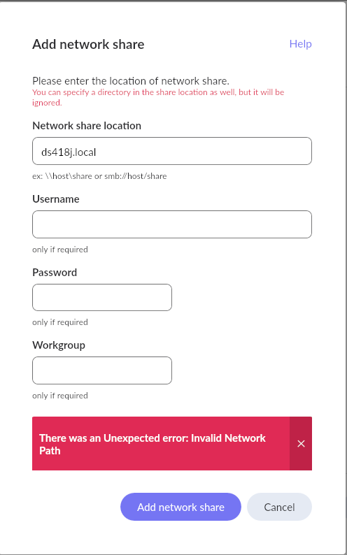

Note: To be able to address a device by its name (ds418j), a working local name resolution system is needed. Most home networks don’t have that. If Zeroconf/Bonjour is used, try ds418j.local instead.

Roon screen of Add Network Share - when you hit Add Network Share you see a Roon logo and ‘Adding’ for a few seconds before the error message.

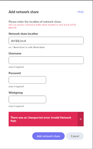

Bonjour is on here, I tried ds418j.local result was Unexpected Error Invalid Network Path
