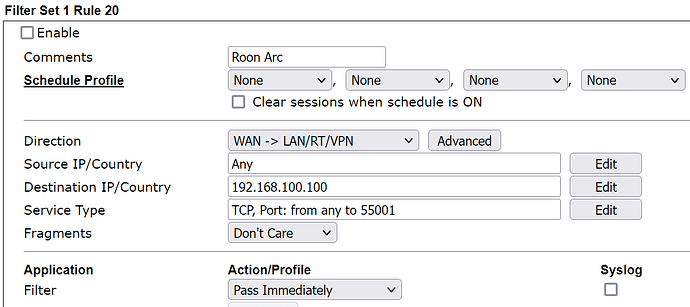

Have you set up port forwarding in the draytek?
Assuming that 192.168.100.100 is your Roon server’s IP:
Open Port example:
Firewall rule example:
Many thanks for the detailed info. Arc is working again!
