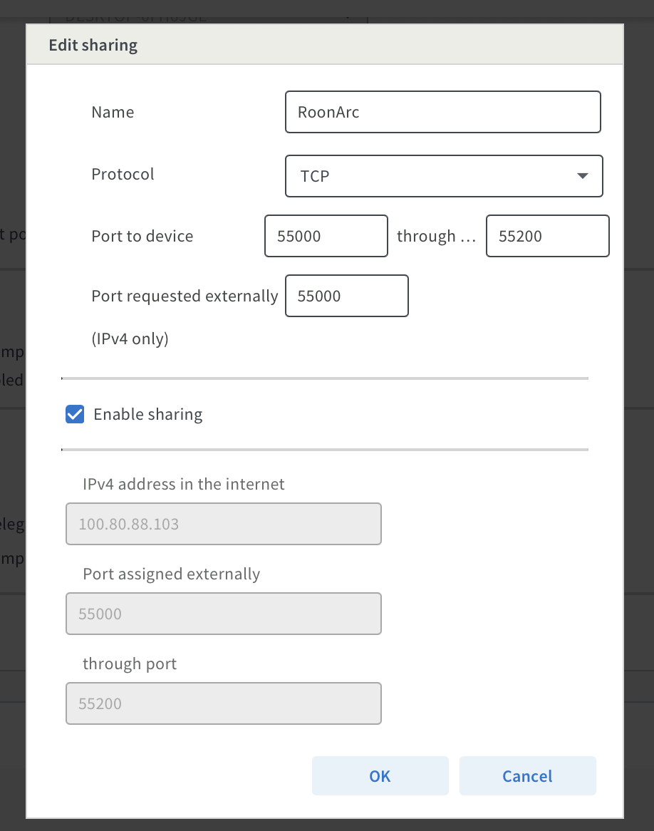

  2. If that doesn’t work, then re-enter the Fritz!Box web administration page and turn UPnP off entirely. Instead, in the Port Forwarding section, create a TCP-protocol port forwarding rule that points to the Port Number and IP Address listed in Roon Settings → ARC>

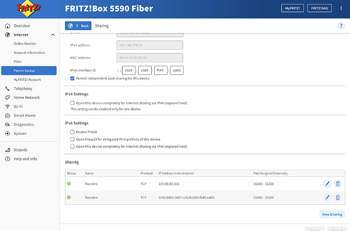

Hello @connor thank you . number one : tried ,no result. No 2 As far I could I tried. No result. See screen shot.
Can you do something with this info?
