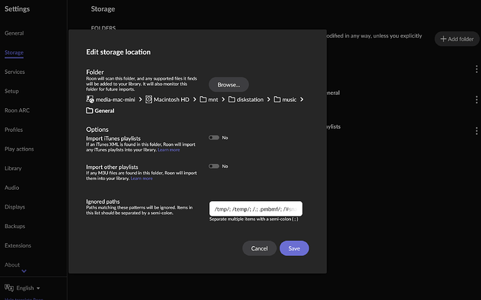

I travel quite a lot and I’ve recently been adding more CDs to my library only to realise I didn’t force a rescan of the storage on the server.
My Server is a Headless Mac Mini M4, with my music stored on a Synology NAS. The music is accessed from the NAS by the Mac using NFS mounts. As the music isn’t held on the Mac the auto recognising of new tracks doesn’t work so I have to manually force a rescan.
Anyway, it would be great if I could also force a rescan from the Arc App.
There is an auto-rescan interval - this should work.
Maybe I missed it, where is that located ?
In the settings of the watched network share in Roon, I think
There’s no auto-rescan interval if I edit the network share
It’s somewhere - many NAS devices don’t properly announce new files over the network, and a regular auto-scan is the normal solution. @DDPS can you tell us where the NAS sync interval setting is?
Well the inotify based file “announcement” is more relevant when using local (non-network) drives (i.e., RoonOnNAS with local NAS storage).
The Automatic Rescan Interval is only available when using networked storage volumes. And while @James_H is indeed using networked storage, Roon doesn’t know that right now because his configuration is pointing to the local mounted volume rather than the “raw” SMB mount.
If @James_H reconfigures his storage location to point to smb://{NAS address}/music instead, then he should see the Automatic Rescan Interval setting, I believe…
That said, he might not even need the Automatic Rescan Interval if he wishes to use the tips at A Roon on (Synology) NAS Primer to increase the inotify limits on the NAS.

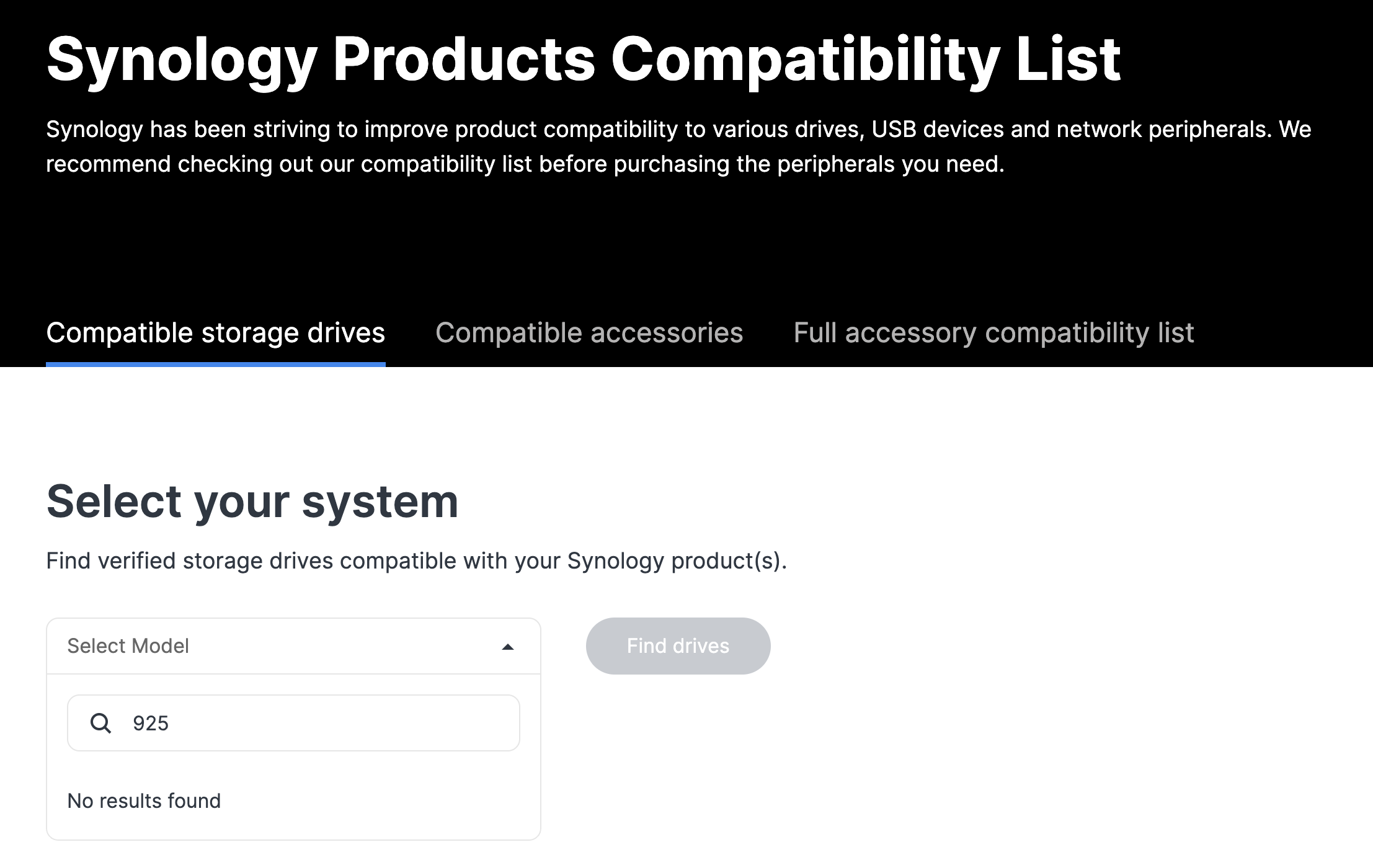

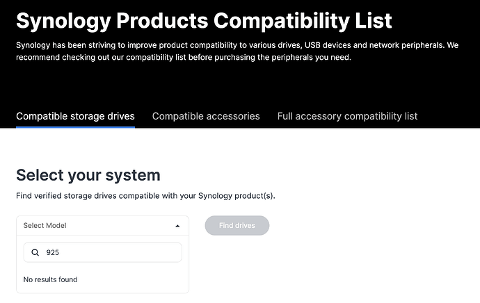

And then there is this:
Interestingly, the compatibility page no longer allows you to look up any xx25 products at all right now, e.g.:
Whereas a couple weeks ago, they did indeed list only their drives.
I think this is moving a bit, and expect some openings moving forward. For me, so long as WD decides to go for the new certification process, I will be happy.
