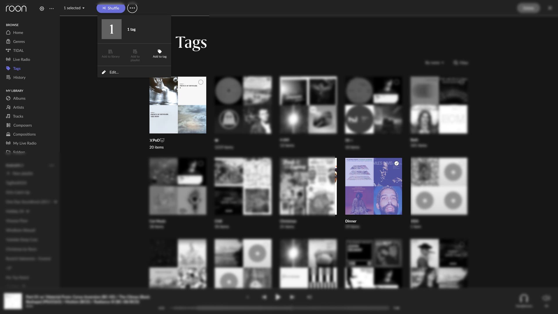

Hi, I’ve posted before about how limiting I find ARC without the same tag functionality as Roon, which I use A LOT at home.
Recently, I thought I’d see if I could ‘dump’ the contents of a tag into a playlist, for use away from home. But it doesn’t appear there’s any easy way to do this either. However, it looks tantalisingly close, see grab. I can select an entire Tag, and there’s an ‘add to playlist’ option, but it’s greyed out…
Could this be enabled relatively easily?

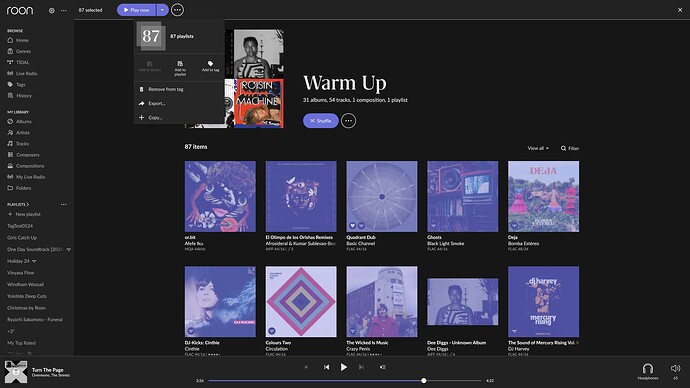

However, the immediate ‘add to playlist’ is greyed out, but the option at top left isn’t. A pop-up tells me that 87 items have been added to the selected playlist, but…the playlist is still empty!
Your selected Tag is used for 31 albums, 54 tracks, 1 composition, and 1 playlist. You will probably need to de-select the 1 playlist in order to add all of that content to a playlist, because playlists can’t be nested as far as I know. After you do that, you s/b able to go into that 1 playlists and all all of that content to your other playlist. Hope that makes sense.
Thanks for that, but still doesn’t work. Even a relatively small tag, with no albums or playlists, just a few tracks. Says they’ve been added, but they haven’t… :face_with_raised_eyebrow:
