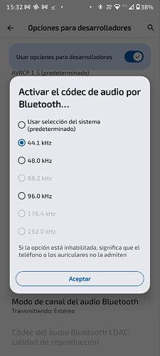

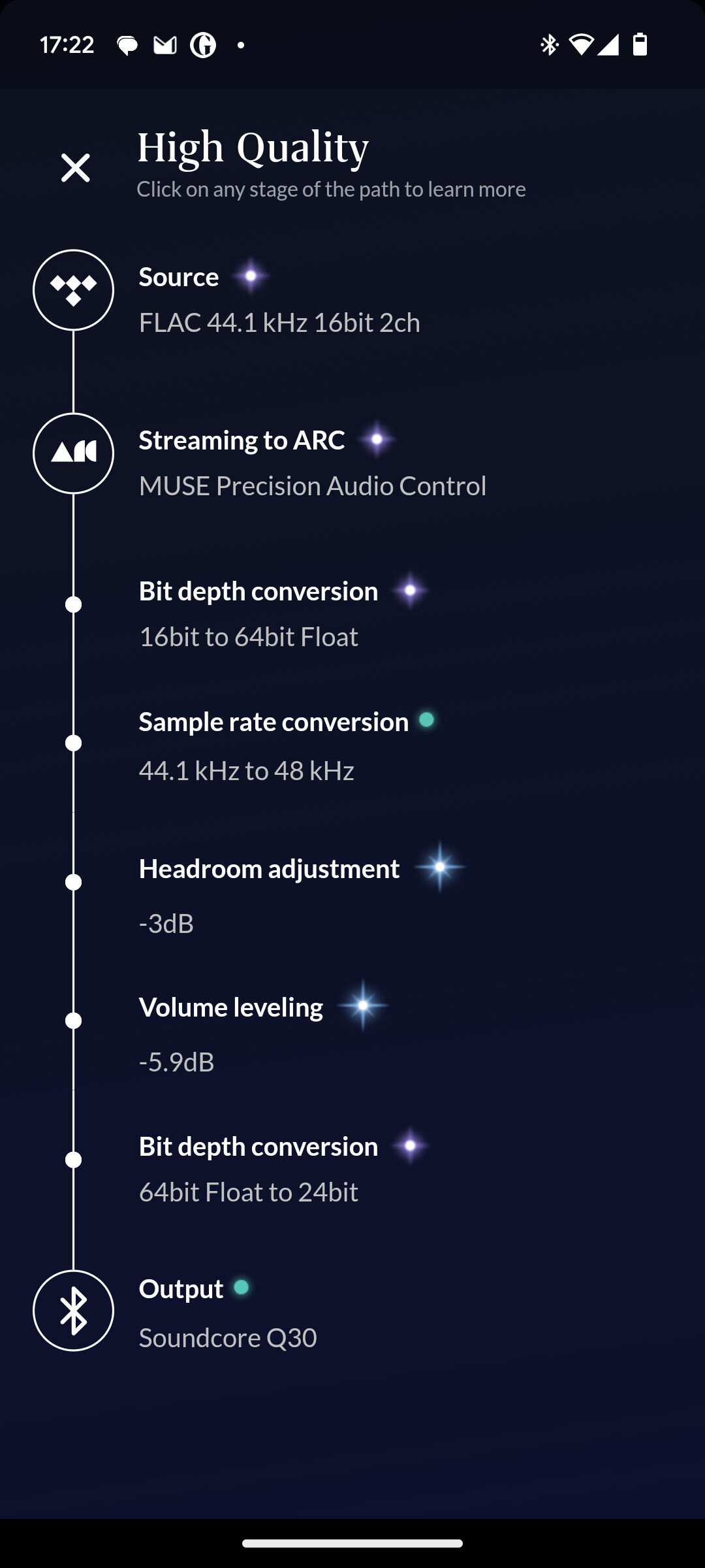

I own a Motorola Edge 50 Pro with support for AptX lossless and a Fiio BTR17. I managed to connect both using that codec after selecting 44.1kHz in developer options, otherwise it uses AptX Adaptive with 48kHz. However, even with this configuration Roon ARC is upsampling the audio to 48kHz and that happens regardless if I disable all DSP. I may be wrong, but I understand Android 15 is able to manage BT audio in 44.1 without resampling
Stock Android only supports 48 kHz, so Roon ARC will handle the conversion, since it does this with greater precision. I doubt ARC would check for the developer options in this scenario, and currently, as you say, ARC only supports other sample rates using USB.

Looking at the signal path you posted, Roon only sees the FiiO, and, therefore, doesn’t know that AptX is upstream.
However, this is no different to using Android Audio, which is resampled to 48 kHz.

Roon ARC identifies my Fiio as supporting only 48kHz through BT. Maybe the problem is just there? If one could override the supported frequencies I guess everything may be done at 44.1kHz?

It’s unclear if Roon ARC queries Android for supported sample rates and bit depth, or simply defaults to 48 kHz. You could request that ARC supports other resolutions in Feature Suggestions.
However, I note that ARC does recognize my Bluetooth headphones when connected to my Pixel 7. In your screenshot, only the DAP is shown, so this may be the issue.

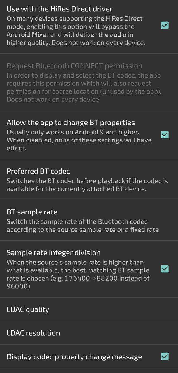

I had no idea. Following your suggestion I tried the same in UAPP and it seems to work fine. I picked bitperfect and Direct Driver. By the way, the sound is impressive with my 64 Audio earphones.
So it seems that, in fact, Android is capable of delivering the file untouched at 44.1kHz through BT in a lossless way. I attach some screenshots for you to check if I’m doing everything right before creating a feature suggestion.
