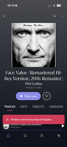

ARC shows "Problem communicating with Qobuz" on some EU networks -- Qobuz CDN issue, investigating (ref#JMLBMA)

Same issue here: ARC unable to stream Qobuz “due to communication issue”.

When doing some tests, Arc succeeds to play Qobuz tracks when connected to my Wi-Fi home network but fails when not on the Wi-Fi (4G/5G).
