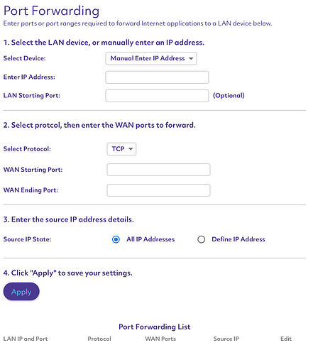

And finally, port forwarding admin page attached.

  1. Disable UPnP and create a Port Forwarding rule. In the LAN device section, enter the IP address from the Settings → ARC page in Roon. Use the port number listed for both WAN port entries. This should be a TCP rule.

Good news. Arc is now working with my Quantum Fiber ISP. I disabled UPnP and successfully created a Port Forwarding rule. I’m not sure what I did wrong on my first attempt but Arc is now working fine.
