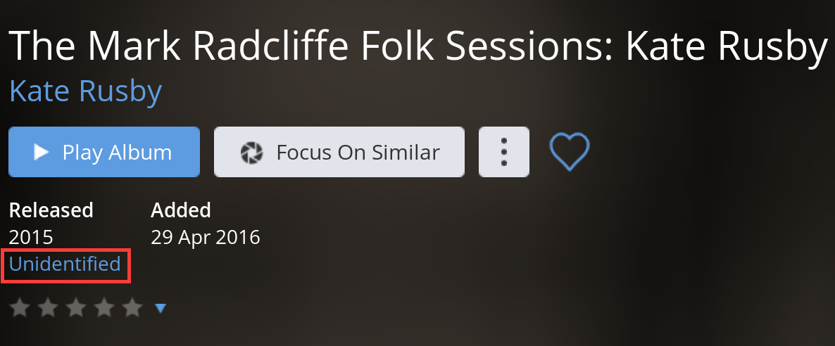

Hi @Nick_Stamp. Roon album “identification” is a very specific thing. Please can you confirm that the two albums displaying as “Beatles, The” have actually been identified by Roon? (if you click on the album, is there a clickable “Unidentified” link under the Released/Added dates?
FYI, at the moment, we don’t do any artist name disambiguation on the Roon client (as opposed to in the Roon Metadata Cloud). From what you’re describing, it sounds like the albums have not been identified and you’re simply getting the album artist values from your tags. Assuming this is correct, there are a couple of things that you can do, but I’ll wait for you to get back to me first.
Joel
thanks Joel; yes, they are showing as unidentified.
I have now gone and gone through the identify process to match the albums, and that has solved the problem.
