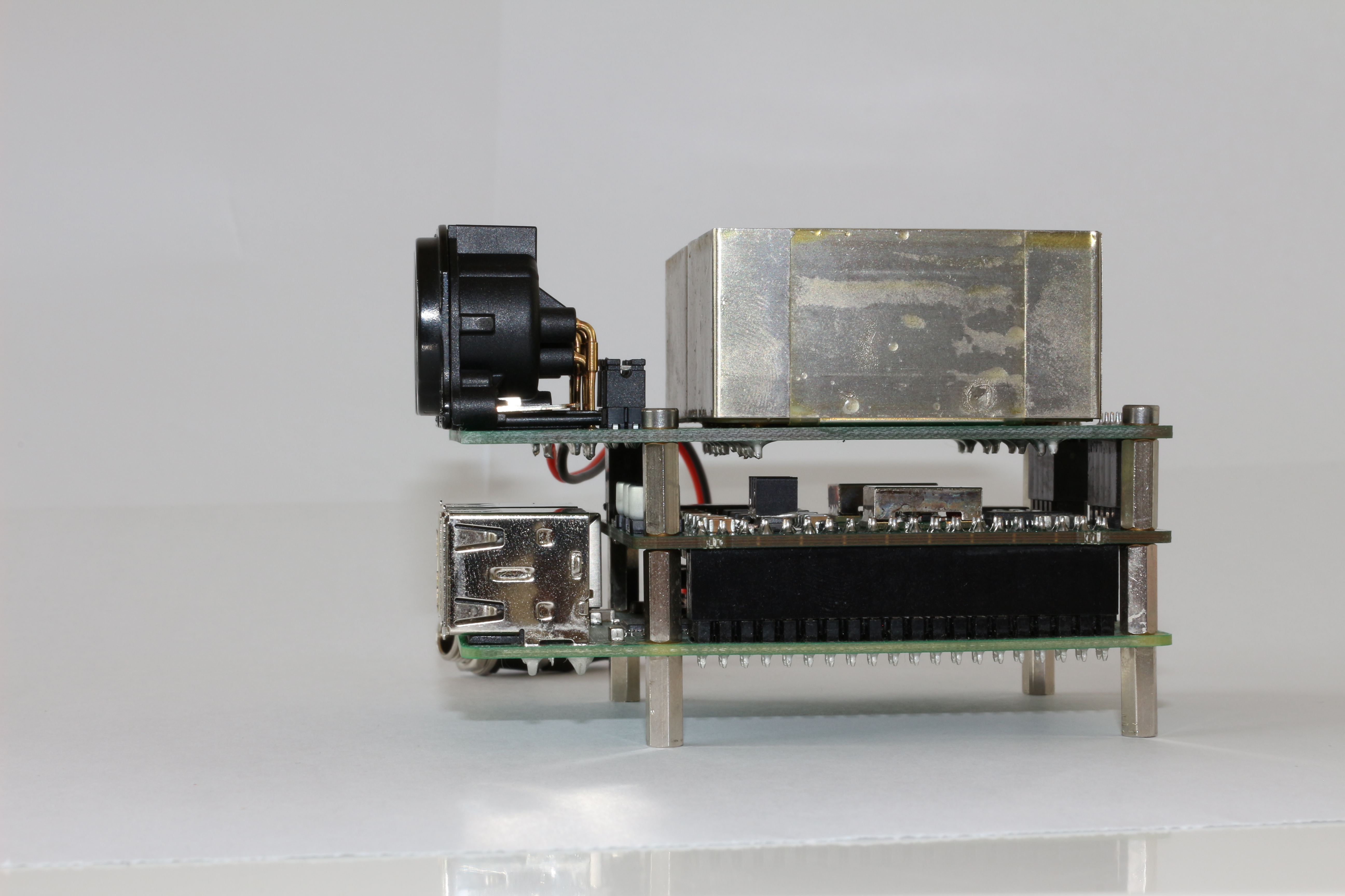

For those interested in the balanced outputs here is some eye candy. It’s the Lundahl output transformers that caught my attention. Some of the lumin’s use this brand on their outputs too.
