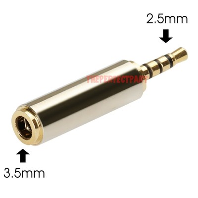

Can’t find it ATM but…
You could do this, a bit klutzy but it should work.
Works great - high quality manufacturer.
I would newer use such adapters for the A&K, because the 2.5mm jack isn’t so robust and the adapter becomes a lever.
If you don’t want to change the cable (to pentacon), then it’s better to use a small adapter cable (I had one from xlr to 2.5 mm and also from 6.3 mm to 3.5 mm for my A&K SP2000)

However that 2.5mm plug showing in the picture does not look like it is a balanced version, may just be a generic picture though.
Not that I am sure it would entirely matter in this instance .
Not entirely sure an adapter vs a cable end would act any differently in the A&K 2.5mm socket but I have not destruction tested one.
Had a typo in my Posting. I meant to use an adapter cable from 6.3 mm to 3.5 mm, because it doesn’t make sense to connect the unbalanced headphone cable to an balanced input.
