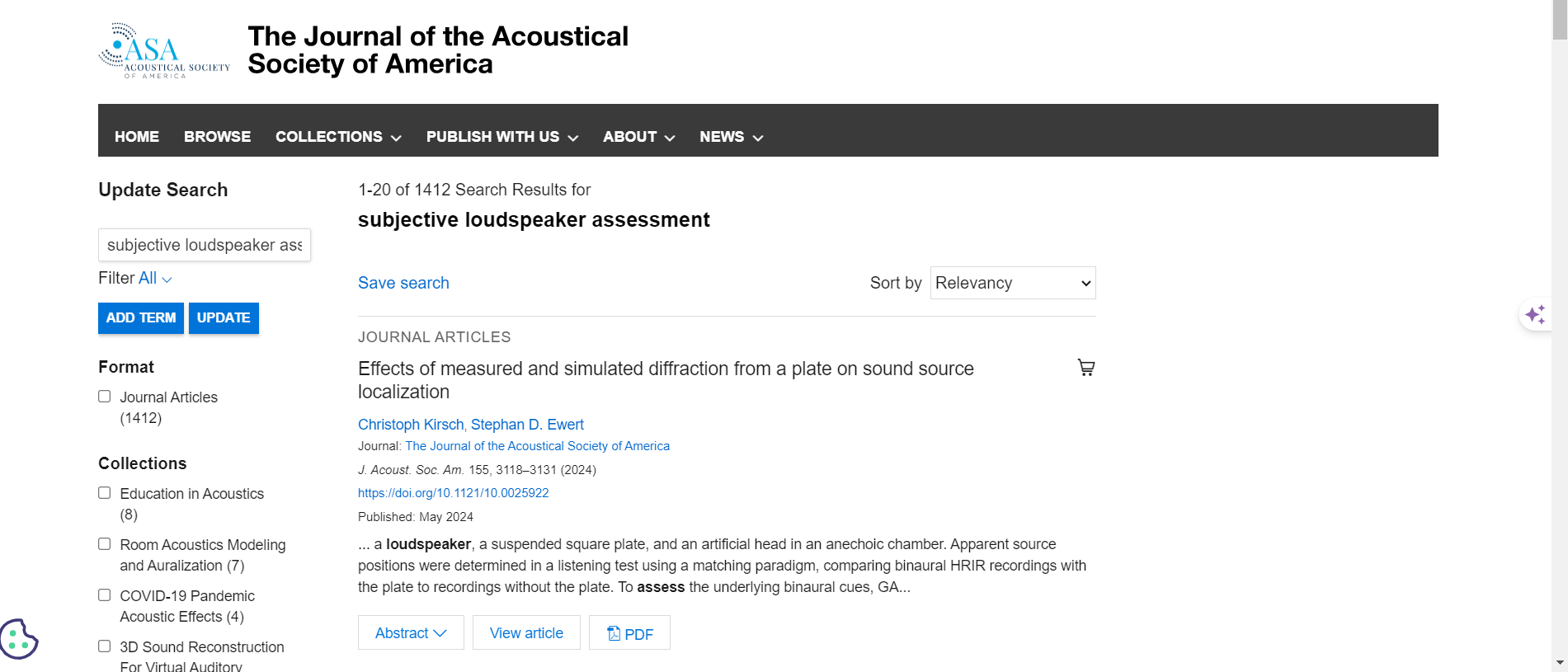

I have no training, academic or otherwise in sound engineering so I asked chatGPT:
You
What journals publish research on subjective loudspeaker assessment?
ChatGPT
Research on subjective loudspeaker assessment is typically published in journals that focus on acoustics, audio engineering, and related fields. Here are some key academic journals where such research might be found:
  1. Journal of the Audio Engineering Society (JAES) - This is one of the most prominent journals in the field of audio engineering, covering a wide range of topics including loudspeaker design and subjective audio evaluation.
  2. Journal of Sound and Vibration (JSV) - While this journal primarily focuses on the physical aspects of sound and vibration, it also includes research on how these factors affect human perception, which can be relevant to loudspeaker assessment.
  3. Journal of the Acoustical Society of America (JASA) - This journal publishes a broad range of research in acoustics, including studies on the subjective and objective assessment of audio and loudspeaker performance.
  4. Applied Acoustics - This journal covers applications of acoustics in various fields, including audio and electroacoustics, where research on loudspeakers might be featured.
  5. IEEE Transactions on Audio, Speech, and Language Processing - Although focusing more on signal processing, this journal occasionally publishes articles on audio systems and their perceptual evaluation.
These journals offer peer-reviewed articles that provide in-depth studies on how listeners perceive different loudspeaker systems, often involving comparative studies, listener tests, and evaluation methodologies. If you are looking into publishing in this field or seeking to read up-to-date research, these journals would be good places to start.
The Journal of the Audio Engineering Society (JAES) seemed promising so I went there and searched on “subjective loudspeaker assessment”. I got 1,412 hits.
Now many of those hits may be duplicates in articles and many probably don’t have much to do with “subjective loudspeaker assessment” or are at best tangential. Maybe I should have used a different search term. Please correct me. But this journal was established in 1929, 95 years a go so the topic would indeed appear to be somewhat niche in academic terms but that may well bear little relationship to the topics impact in terms of engineering and productization.
What is clear on even the briefest scan of this material is that it is immensely complex and specialist and even subject to ITU international standardization which kept coming up.

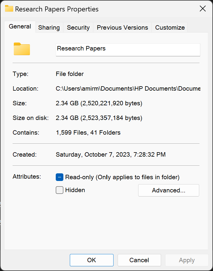

This is why I am able to quickly reference and post papers to back what I am saying.

I don’t understand how some see no useful knowledge or references, and i see pure gold. And a challenge to see what is true! What more could we ask for to advance our understanding of how to achieve the best quality sound?
