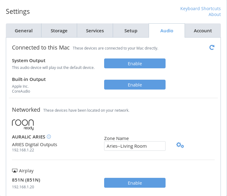

I’m streaming music to my Auralic Aries via RAAT protocol and everything sounds great. My initial setup was easy as my Aries showed up in the Audio Settings menu under the “Networked” devices section. I simply enabled it and labeled it as my Living Room. But I am confused about this talk of setting up Exclusive Mode, which seems to be regarded as the best configuration. I don’t see any such option for my Aries. I only see Exclusive mode as an option for devices in the “Connected to this Mac” section at the top of the menu. Most of my music plays losslessly (indicated by the purple indicator light in the signal path), but a small number of Tidal albums show the orange indicator light and the community has suggested that Exclusive mode is one solution to this issue.

Exclusive mode is only relevant for devices connected to a Mac/Win system directly. Your Aries is a RoonReady certified network device – that means Roon is fully aware of its capabilities and the optimal way to use them.
Your signal path looks perfectly fine – the yellow dot when using Tidal indicates that you have stumbled upon an album that is not lossless (Tidal still has a bunch of music that’s only available in lossy format). You signal path will show it’s not playing a lossless FLAC file.

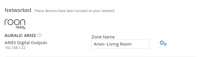

  • In order to choose DoP you will have to access your zone settings by going into your “audio” tab (found under “settings”) and clicking the gear to the right of your Auralic zone as seen in the example below.

Hi Eric,
in the zone where my Aries is, clicking the gears only gives me a general tab. there is no playback
tab available. Why is this?
Ken
Hi Ken,
I do use an Aries LE connected via Network/Wifi.
DoP and Software Volume settings are done on the Aries itself.
The other TAB and settings are only visible when you directly connect the Aries to your RoonPC.
My settings in Roon are no Resync and no max sample rates. ( I guess that is default)
DoP is enabled on the Aries (DAC should support it of course) . Volume (remote) control disabled.
