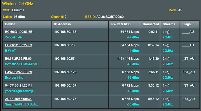

You can also see that both the A7 and Zeppelin are of the old Wi-Fi “g” standard, I wonder if this is having something to do with the issue.
Believing this to be a home network related issue, I spent much of Sunday resetting my home router and wi-fi network.
I reset the Asus RT-AX88U to its default settings and re-attached the 12 wireless items in my home.
Unfortunately this hasn’t helped in any way whatsoever.
