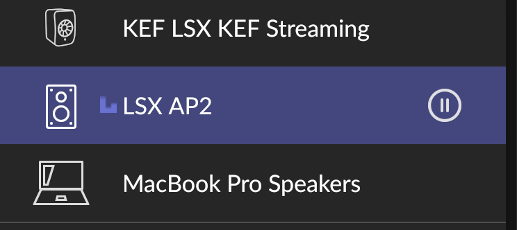

Original version KEF LSX: AirPlay does not work in either Compatibility mode Yes or No. Also, while nothing plays, the Play button does not change to a Pause buttong, and the track progress bar does not move, I happened to see the LSX AirPlay zone showing an active play icon in my Zones list, screenshotted below:

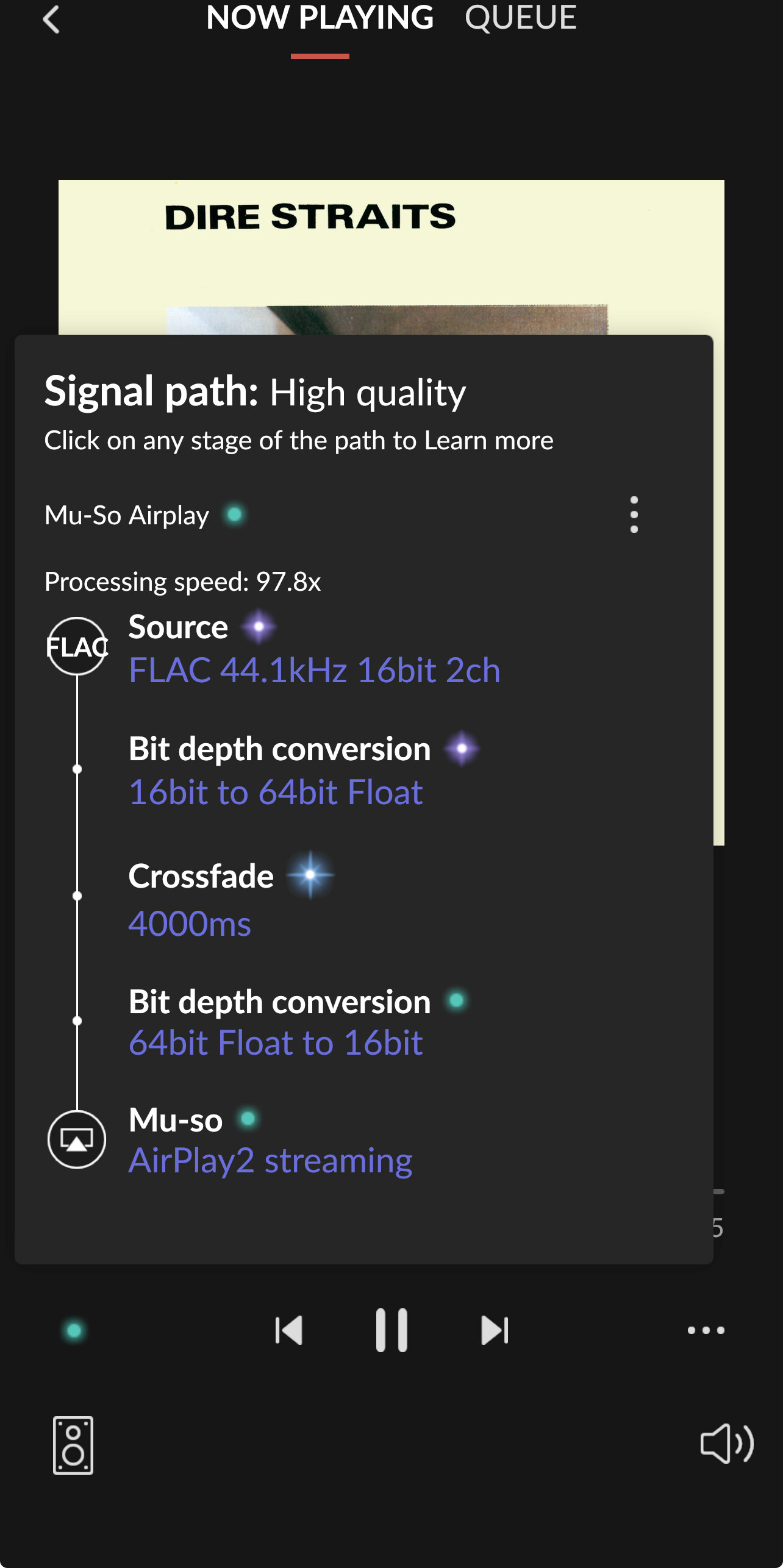

Naim MuSo Gen 1 still airplay fails to play with or without airplay password and with/without compatibility mode.
Can anyone with one of these devices get it to work?
Update 18:52 GMT:-
Moved the device to a hardwired connection and did a factory reset:-
Seems to be working in compatabilty mode

So I was on Roon earlier today, and for some AirPlay devices, the devices need to be added to Apple Home. The Roon Help article is here:
Once I added my original LSX to Apple Home, AirPlay works correctly now. I believe 1430 should be deployed into the Production Build.
