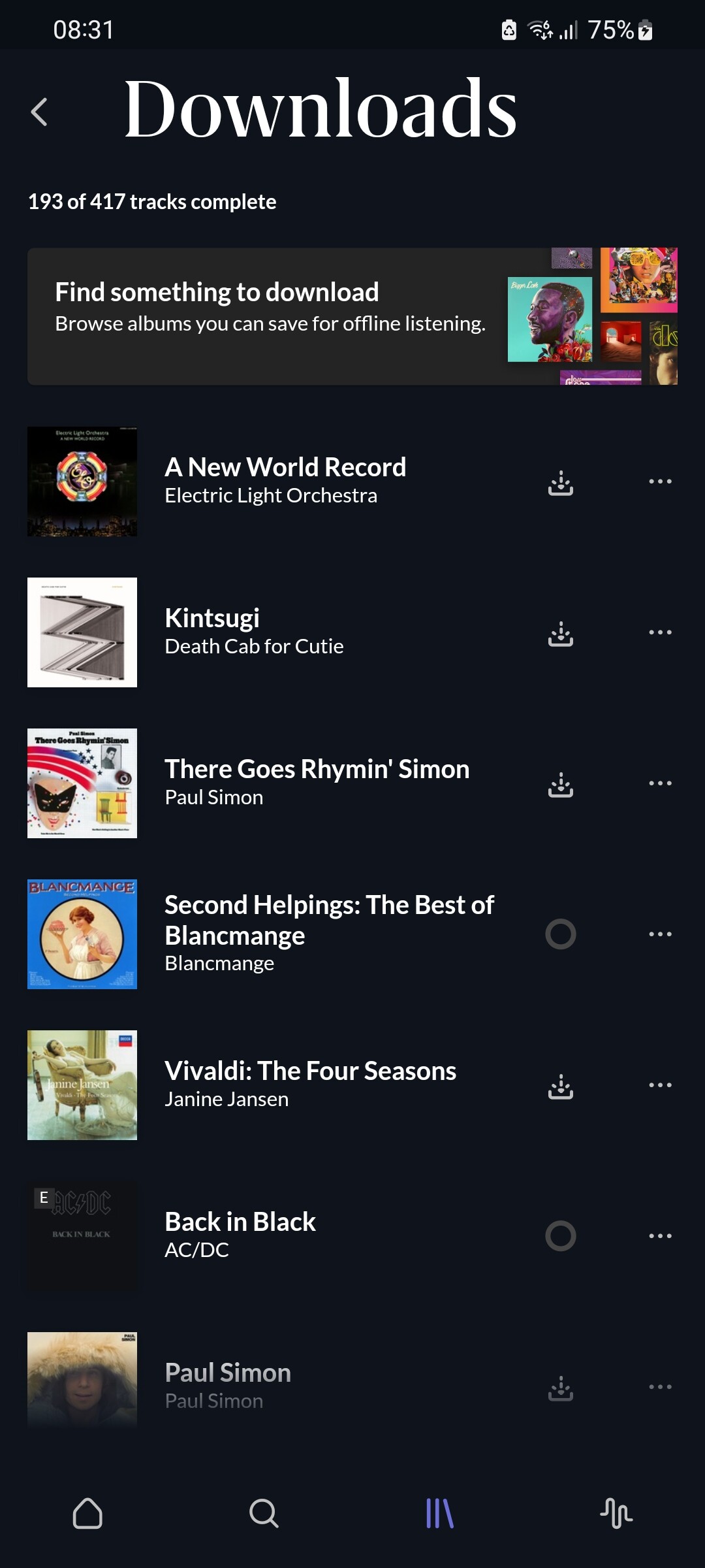

I’ve seen several threads reporting slow download of albums from Core to ARC.
While that still seems to be true I’d like to point out one other factor that makes download experience painful:
Download process is terribly unstable.
It frequently:
  • pauses (and often doesn’t resume)
  • stops with ARC app still responsive
  • while working in background often stops and when you switch to ARC it just restarts
Actually the only predictable way of downloading is to have the app in foreground and don’t let the screen go off. Then it usually works constantly.
I’m trying to download ~4500 tracks since Wednesday morning and still have 2000+ to download. All is happening in fast home WiFi (5G).
It might be partially related to Android battery saving but there are apps that handle similar processes in a seamless way (Tidal, Qobuz, Netflix to mention some of them).
On Android you can go to Battery Optimization and turn that off for ARC. Then it keeps downloading consistently and even if the app is in the background or the phone sleeps.
I haven’t noticed any significantly bad effects on battery usage either. It remains slow to download, though.
This setting is not an option on iOS
