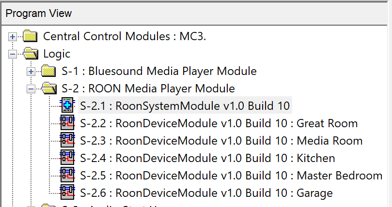

Real quick. You need one (1) RoonSystemModule and a RoonDeviceModule for every zone. See the attached image of my Crestron Roon Modules.
Thanks very much for the advice and the screenshot.

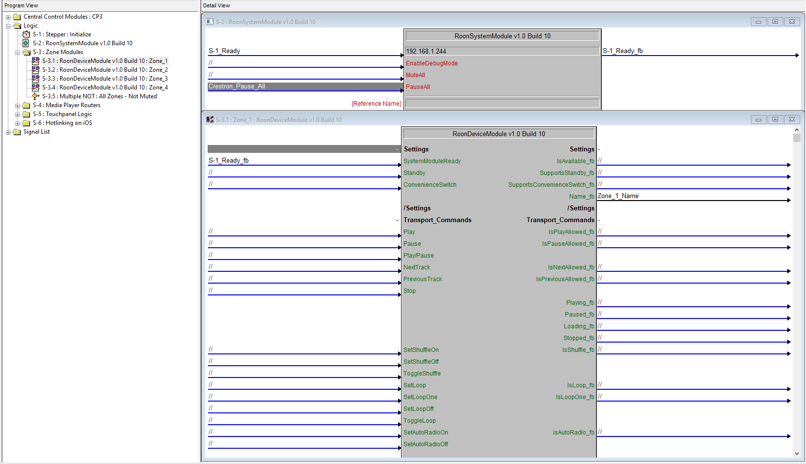

Since I am not very familiar with these, can you confirm whether the Roon System Module will allow me to send a Pause All command to all zones if I decide that I do not need Crestron to control individual zones?
I am thinking that this would be great to add to a Goodbye button on a keypad.

Yes, there exists a Pause All command in the Roon System Module that can perform this function, please see the screenshot below with module commands available (please note that CRPC communication is also possible if they wish to integrate into a Crestron Media Object):
No, there should be no maximum limit to the zones, although each zone will have to be programmed and configured. Our Example Module on the Roon/Crestron Knowledge Base provides a great starting point.
