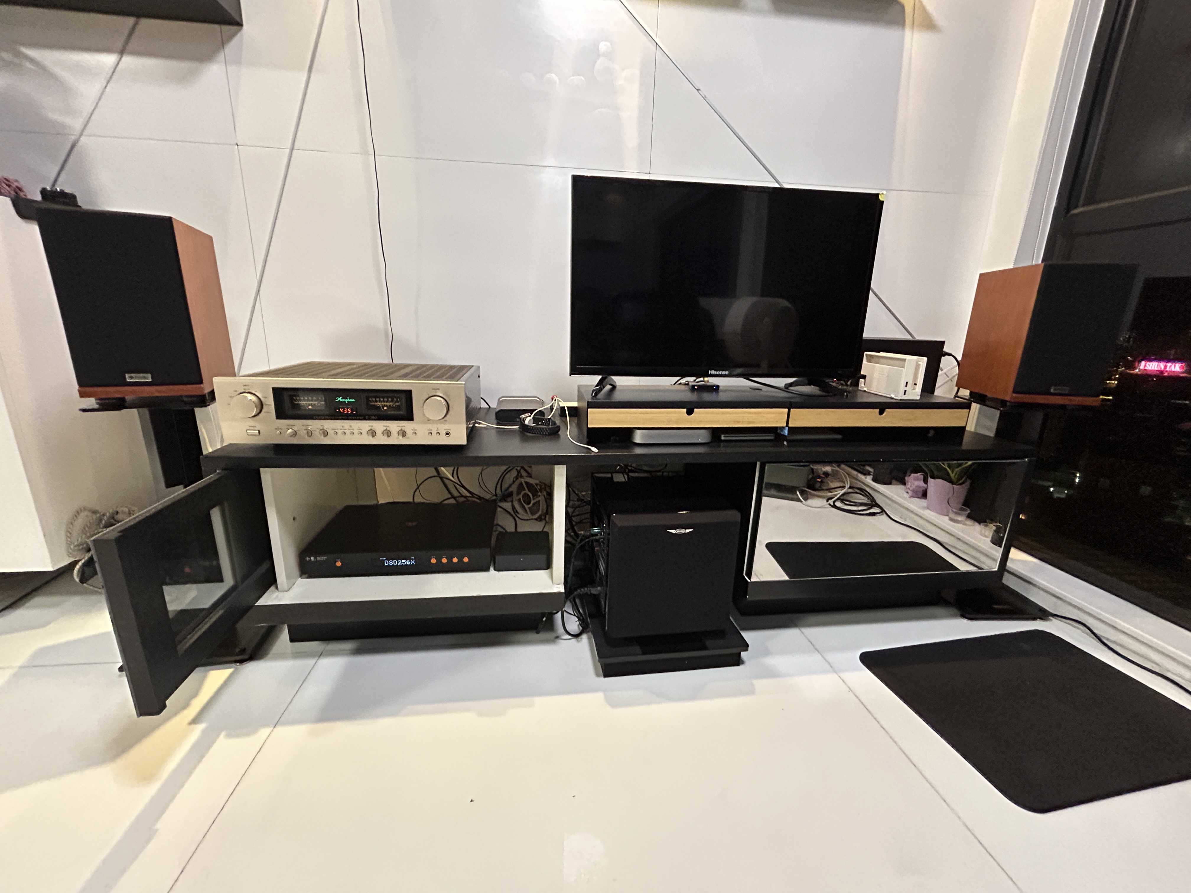

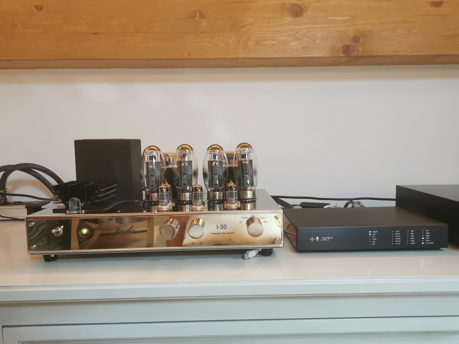

That amp looks beautiful Gerardo. I’ve never owned a tube amp, but always thought they looked so good.
Thanks Steven and it has a wonderful QS :heart:

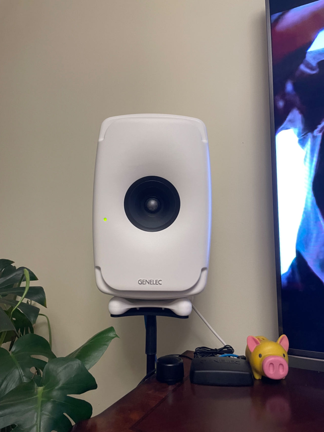

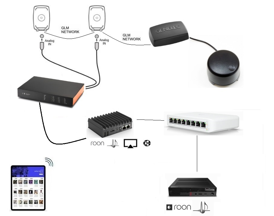

I’m using Holo Cyan2 with Genelec 8351b.
So far, it’s working pretty well。
You are also listening to the cheap Genelec A to D and D to A chips, and their average digital filters, last in your playback chain
Basically you undo the excellent HQPlayer + Cyan2 clean analogue output
Better feeding it digital input with HQPlayer upsampling to PCM192k
:pleading_face:
We have a separate thread for it:
At least in the 8351A, internally 24/96 is used. 24/192 is accepted but downsampled. Not sure if this is still true for the 8351B. That’s why I do not bother with HQP and my 8351A. I let up or down sample all by Roon to 24/96 and have a simple Topping D10s converting from USB (from Rpi4) to Spdif.
If the ipad control app would allow to switch output I would probably go to HQP.

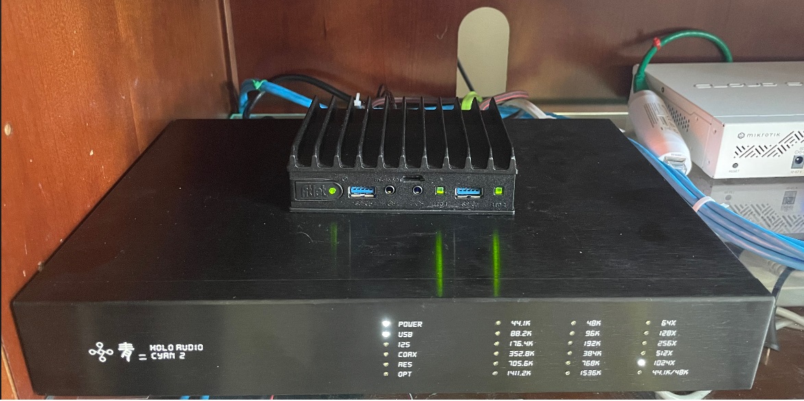

Hello everybody,
Cyan2 is on another galaxy and I’m very happy to own it.
I have just a simple question: what is the best buffer time using rpi4 and cyan2?
HQplayer Desktop + Ubuntu 22.04.04 and low latency by JL :wink:
Thanks in advance
Gerardo
Just use the default buffer value is @jussi_laako ’s rec, as long as playback is fine.
If you have dropouts or pops/clicks with transitions you might experiment with larger values.
Thanks so much indeed
Gerardo
I choose 250ms then you can push more demanding filters with less droppings.
