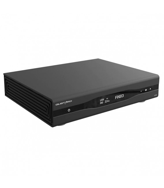

K2 is the Gustard clock.
In order to provide an accurate clock signal, the A26 features the ultra-low noise K2 module. This ensures that the DAC is able to achieve a very low jitter level for the most transparent sound possible.
The A26 also provides a 10M BNC input allowing it to be used in conjunction with an external clock generator.
Ahh, yes, I have spent about 12 hours measuring A26.
It is not particularly ultra low noise:
That widening of the main lobe base is phase noise from the clock. This is through USB input.
And from lan input ? It’s the best input for HQPlayer even i saw, you used a HOLO Red on USB.
I have not tested it yet, as the switch on the equipment rack is out of ports, all 8 ports in use.
At some point I’ll try it out, and also with I2S from Holo Red which would slave the clock to Red’s clock.
Yes, I also tried the same UP Gateway used for that Holo Spring 3 measurement, but the results didn’t change in any notable way.
