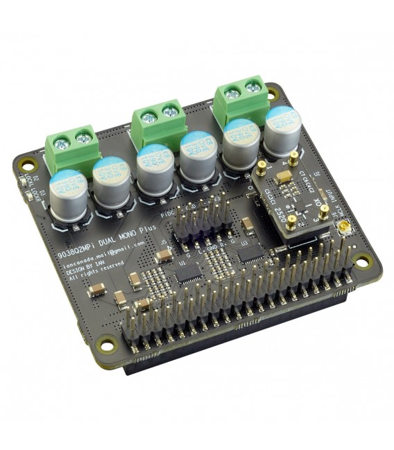

If you want an Hifi Dac pro, choose the top : double mono and clean power !!
But it’s worth assessing your real needs… :wink:
I’ve measured the innoMaker it is well designed.
Haven’t seen any decent measurements of the Ian Canada one.
I can tell you that from doing lots of measurements the past 12 months two DAC chips does not automatically make a DAC good - all depends on implementation (everything around the DAC chips)
And most of their specs are pulled from the ESS datasheet.
Their actual HAT cannot support DSD512 input… even though they say this on their website (because ESS datasheet says it)
innoMaker say the same. But it is good with PCM353kHz input.
