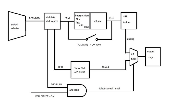

My Gustard contact said this
“We may not necessarily add this feature because it deviates from the functionality of the all-in-one machine and volume adjustment is not available”
I said why even offer DSD if you can’t bypass the SDM modulator. Many more of us don’t need volume control.
These companies are really out of touch.
No one is asking for the garbage they stick on these things lol
ESS has worked like this since forever, so it’s not that unusual.
And nearly all the AKM chips out there without DSD Direct mode work like this.
But yeh if you want HQPlayer’s 1-bit modulator delivered bit perfectly for conversion to analogue, A26 is better choice.
