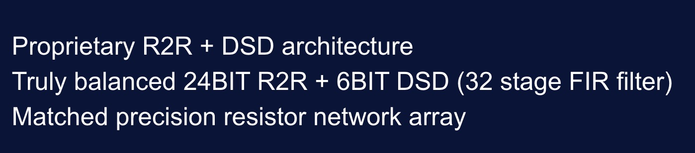

Hello @jussi_laako I have a question. What is your opinion on 6-bit DACs? I have seen the new Garlubidor Divinity https://www.garlubidor.com/blank-3-1 and I wonder if this has advantages or disadvantages with HQPlayer compared to my iFi iDSD Pro and other devices such as Holo Cyan, etc. I guess you haven’t heard that DAC, but I’d like to know what you think. Thank you.
That sounds a lot like Denafrips DAC, including same wording. So maybe it is one of such, available under different brand name. If that is the case, it is not really a bit-perfect DAC.
