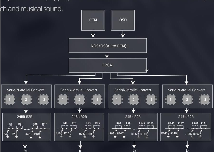

Interesting i assumed it all went through a PCM. Here is an image from the product description.
So, according to your text, there is a way to set it to 1BIT? And this is different than the NOS setting?

If you have full control over how the data is passed to the shift registers (serial/parallel convert), you can also turn it into native DSD converter by providing the data in a different kind of way. Since the front-end is FPGA, you naturally have this control.
So it has some potential for such operation. Would be interesting to try it out.

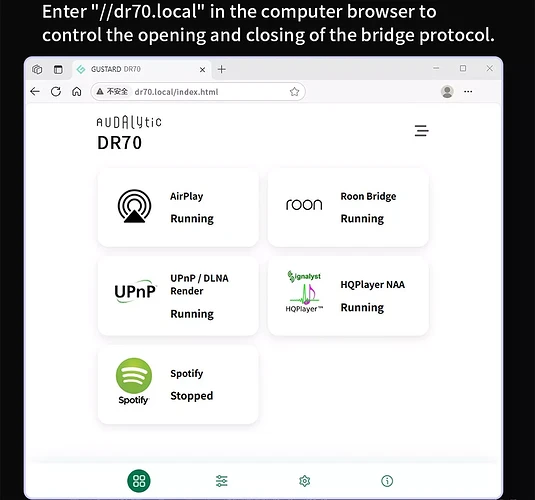

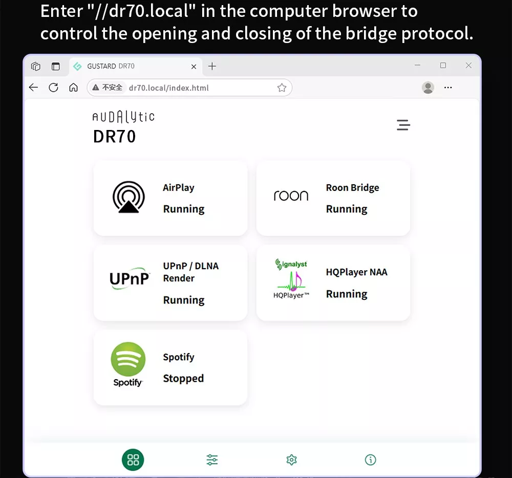

With the DR70, the streaming software is completely different. You can turn on/off services via web browser by connecting to its IP address. That’s much progress over the AH90 which requires hacking it to update it. I feel Gustard has no interest in updating the AH90. They’ve seemingly moved on.

Found this regarding the DR70 from gustard dot com:
