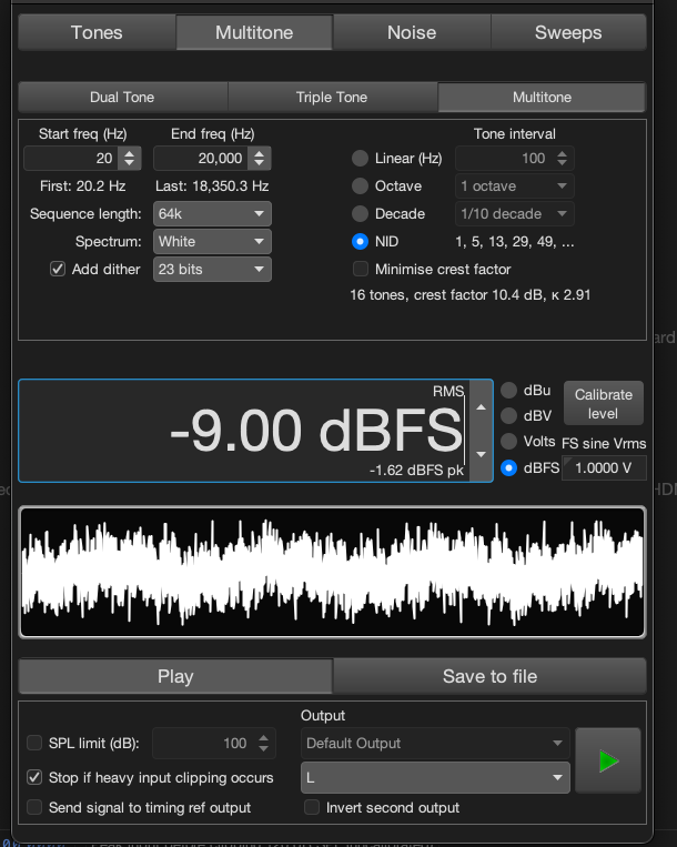

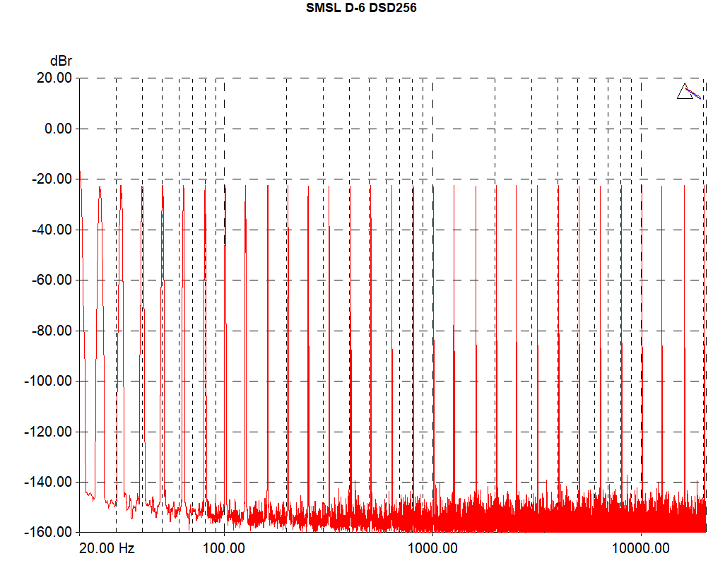

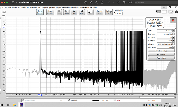

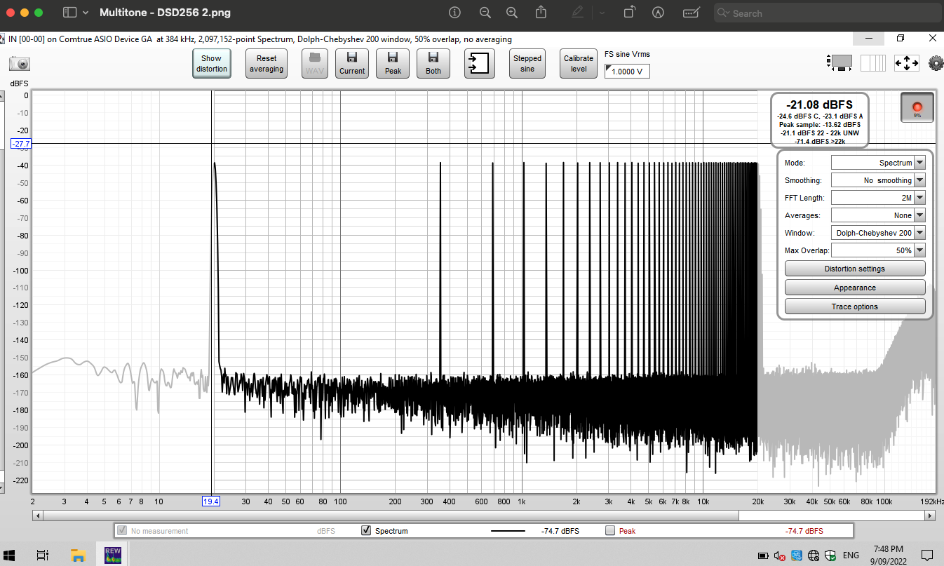

Here is my SMSL D-6 measured in Sep-2022 , DSD256
Different scale to my earlier plot, noise/distortion floor down at -160dBFS
FFT 2M, no averaging
NID multitone peaks are at -1.6 dBFS

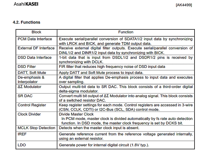

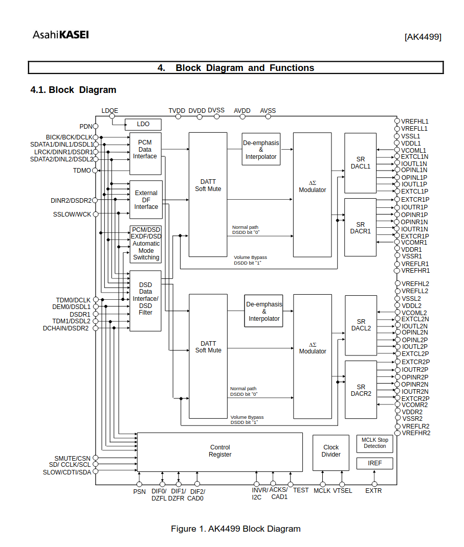

I will have a look around. I basically remember something in terms of the DAC chip itself, but have not saved a bookmark or similar. My understanding was with the pre-amp mode off, DSD Direct was available, insofar as the signal would be fed to the conversion stage.
Update - I have found the AKM AK4499 datasheet, and the block diagram seems to suggest DSD content goes straight to conversion, bypassing the modulator, but I am very much not an expert! Just an idiot with a computer!! Lots of forum posts seem to reference the ā€˜DSD Direct’ being possible, but I have not found anything official.
