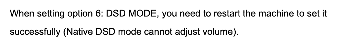

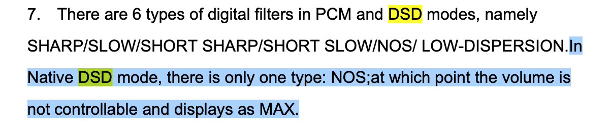

OK I just got user manual from Shenzhen Audio (very fast!)
From below it appears to be DSD Direct mode (since they mentioned volume control is disabled)
Still unknown how it performs until measurements

Anyone tried the SMSL PL200, looks lots of fun, I still spin CDs from time to time. Also, on checking the manual, on page 24 its says “FIXED DSD BYPASS :Open the DSD direct access function. At this time, the volume of PCM or DSD is not adjusted. The output amplitude is fixed to about 3.7VRMS. When this function is opened, the DSD is not processed at all, and the output is directly output.”

I have some doubts about DSD Direct mode on SMSL 4499EX based DACs, since they couldn’t fix this functionality for another model…
Note that this is not 4499EX, but 4499EQ.
4499EX looks like this:
Which is typically used with AK4191 front-end chip.
Technically it performs better in DSD. And when comparing, remember to set PCM gain compensation to -6 dB in HQPlayer settings! Because PCM is otherwise 6 dB louder and could affect the perceived sound.

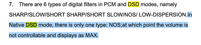

User manual states a “DSD direct” Mode on page 4.
Gustard A18 user manual

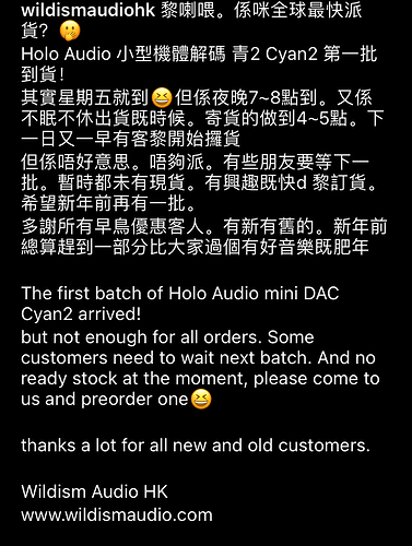

First batch of Cyan2 has been delivered to HK dealer. I’m still a few weeks away from receiving from my friend who ordered
I’ve been at Wildism Audio! Should make an Hong Kong HQplayer meetup :laughing:! You are welcome to join on zoom!
Can you make live measurements on the Zoom !! :joy:
First public unboxing of Cyan2 - nothing exciting but hopefully that means my friend’s unit isn’t too far from delivery
Another Cyan 2 arrived. This guy will be comparing with his ADI-2 (a long time HQP classic ! )
Will Cyan 2 become a new affordable HQP classic? Something original Cyan was not. We’ll soon found out
Cyan2 is approx the price of what the AKM based ADI-2 was
I’m still also waiting mine. We’ll see…
