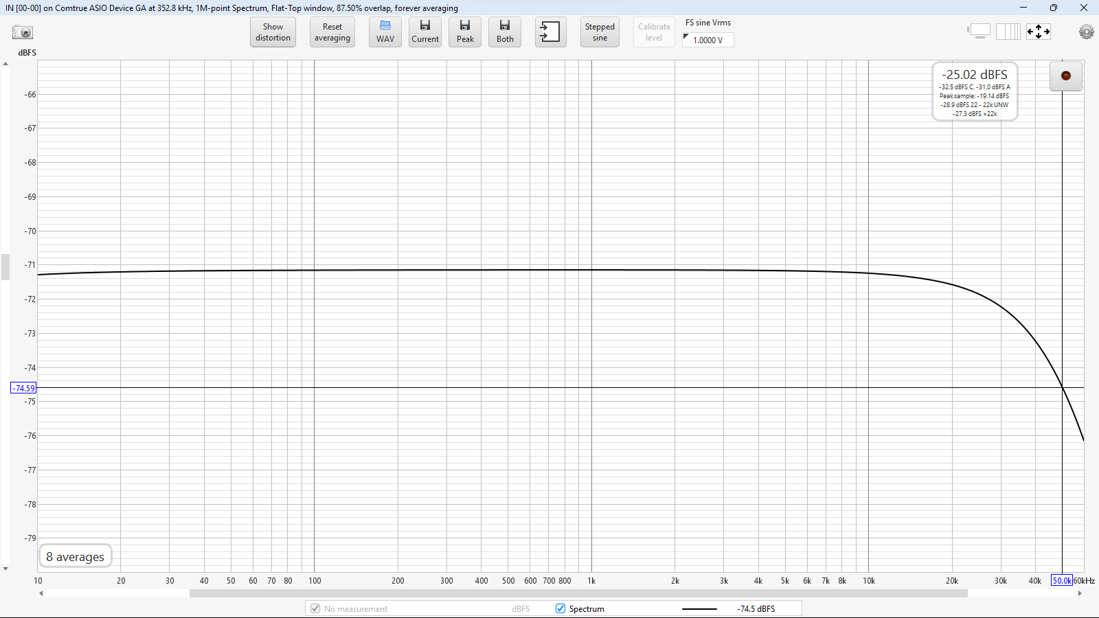

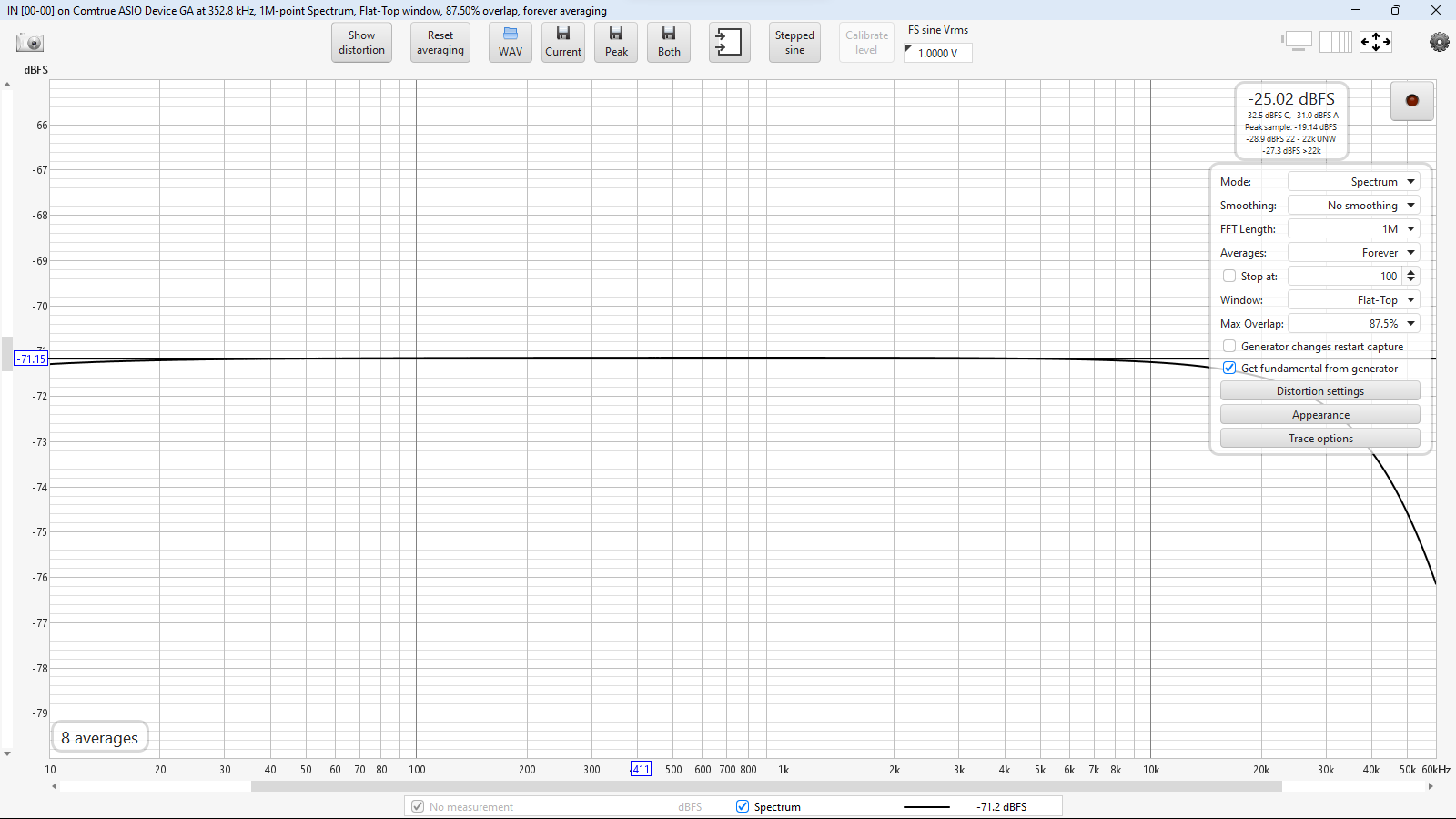

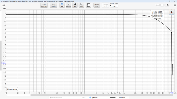

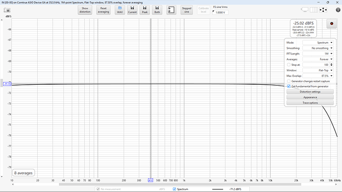

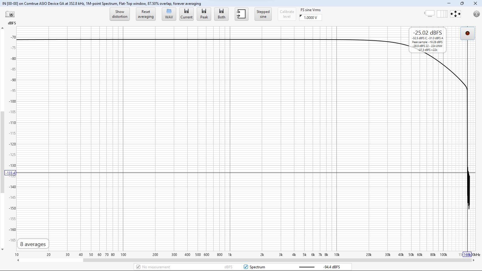

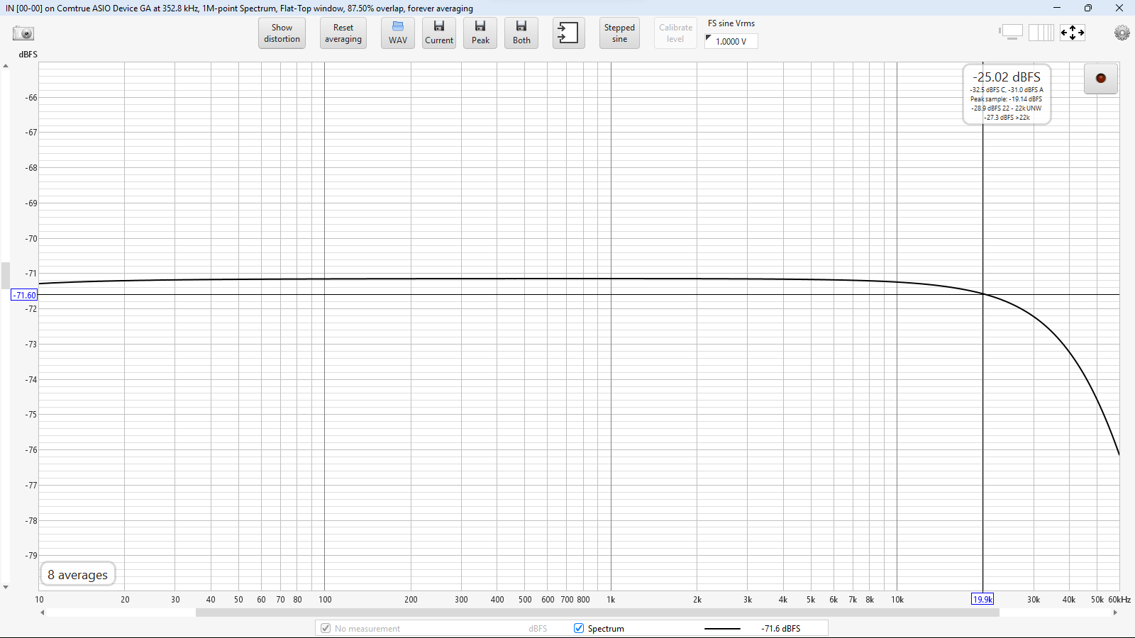

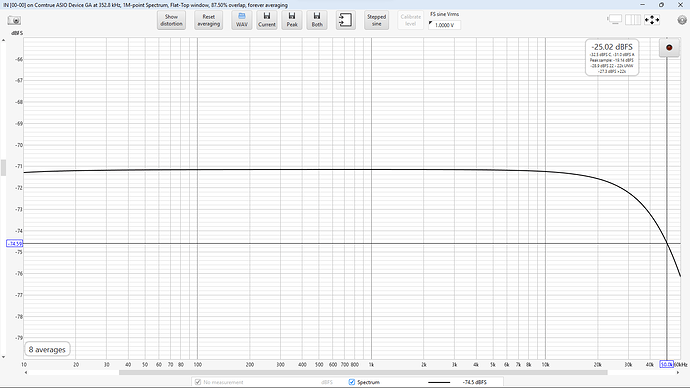

So for completeness for my friend, as a good QA/QC check I checked frequency response for both channels.
I use PCM353kHz periodic white noise test signal → HQPlayer → DSD256 with sinc-S filter
Captured at PCM353kHz by ADC.
Both channels perform the same, which is nice.
Even for the anti measurement crowd, its nice to have the tools to do your own QA/QC check, checking for faults for your particular unit.
0.5dB down at 20kHz (no big deal)
1dB down at 30kHz (no big deal)
2dB down at 40kHz
3dB down at 50kHz

Due to the NOS focus, Holo has such 50 kHz fc (-3 dB point). If you like wider bandwidth, T+A gives you option to choose between two analog filters. A 60 kHz one and a “wide” one. Of course the price is pretty different, which is also affected by the Made in Germany aspect.
Nice to know my measurement was accurate then !

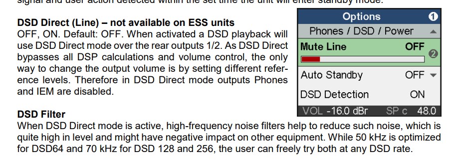

I believe you recommend putting the DSD filter at 50 Hz for DSD 256.
The RME ADI2 documentation indicates instead to use 150 Hz for DSD 256 (and 128), and 50 Hz for DSD 64.
Ultimately what is preferable?
50 kHz setting. Which is sample rate dependent. So it is 50 kHz at DSD64. 100 kHz at DSD128 and 200 kHz at DSD256.
If you have “B” model, these frequencies are different, but the ADI-2 interface didn’t get updated for such.
