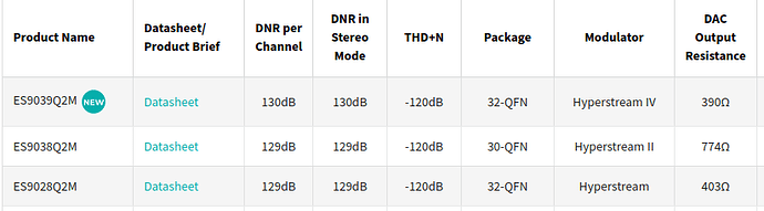

As an example, if you look at the table on ESS website:
This is three different modulators, almost nothing said about these. And I can tell the difference is certainly more than 0 dB difference in SINAD and 1 dB difference in DNR.
More interesting is the output resistance which defines the ultimate noise floor level (higher the resistance, higher the thermal noise).
AKM has four modulators in AK4191 front-end chip, but those are just numbered 1, 2, 3 and 4. That’s it.

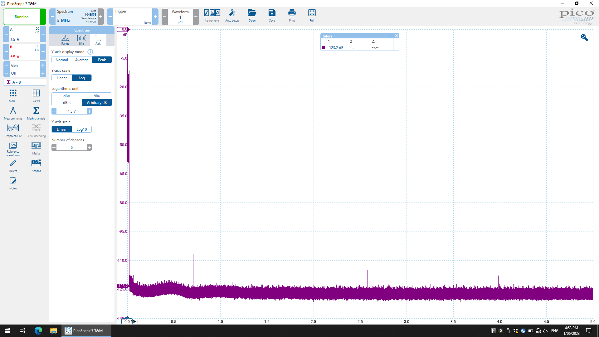

Can you show this for A26 ?

DSD256 input:
44.1k input:
You know this is not “DSD Direct”… Not anything even near.
Essentially this converts DSD256 to 176.4k PCM.

Wait are you showing that the A26 doesn’t do DSD?

I’m still outta the loop here on this measurement. So we have no DSD direct with the A26 even with the firmware fix? Conversion to pcm?
With firmware fix it works correctly at DSD256 and DSD128.
The plot I was showing is the case when it is NOT working correctly with AK4191+AK4499EX combination.
