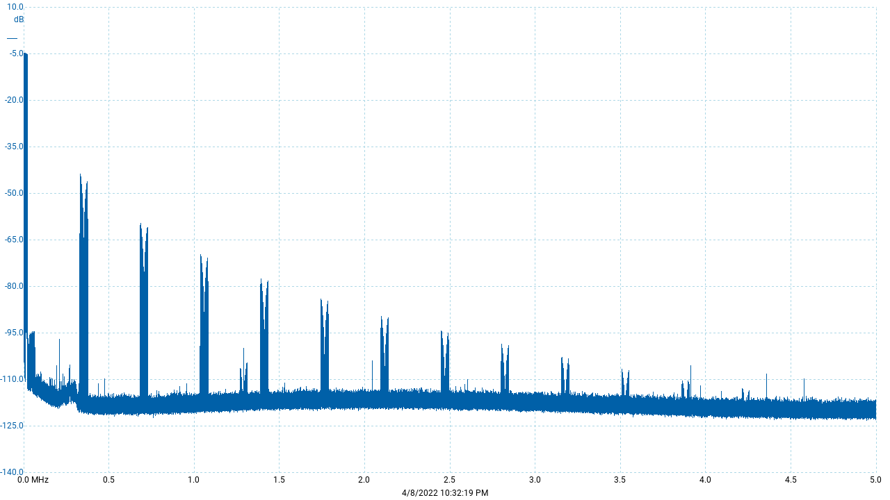

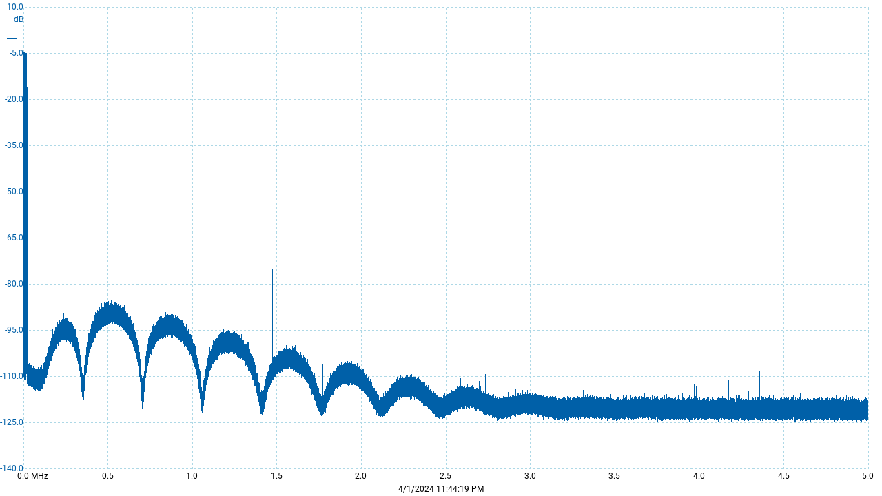

Regarding E30 and sending 44.1k there vs sending DSD256 there…
44.1k input:
vs sending DSD256 there:
High level fully correlated images with PCM input vs very low level of uncorrelated noise with DSD input… (source signal is 0 - 22.05 kHz sweep)

PCM input has distortion components at about -45 dB level (about 0.5%). DSD input has just some unrelated ultrasonic noise at about -87 dB level (0.004% of noise, unlimited bandwidth).
Also lower frequency distortion components with PCM input reach -95 dB (0.002%) while DSD inputs don’t have any of such visible.
So DSD input is massively better.
