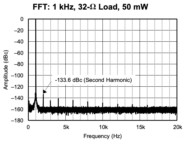

This is from TI’s datasheet:
Screenshot 2024-04-09 at 3.35.06
Possibly your guess of a TI chip being used is incorrect? Because:

The middle one can be compared to the TI’s figure. 32 ohm load, 50 mW condition.

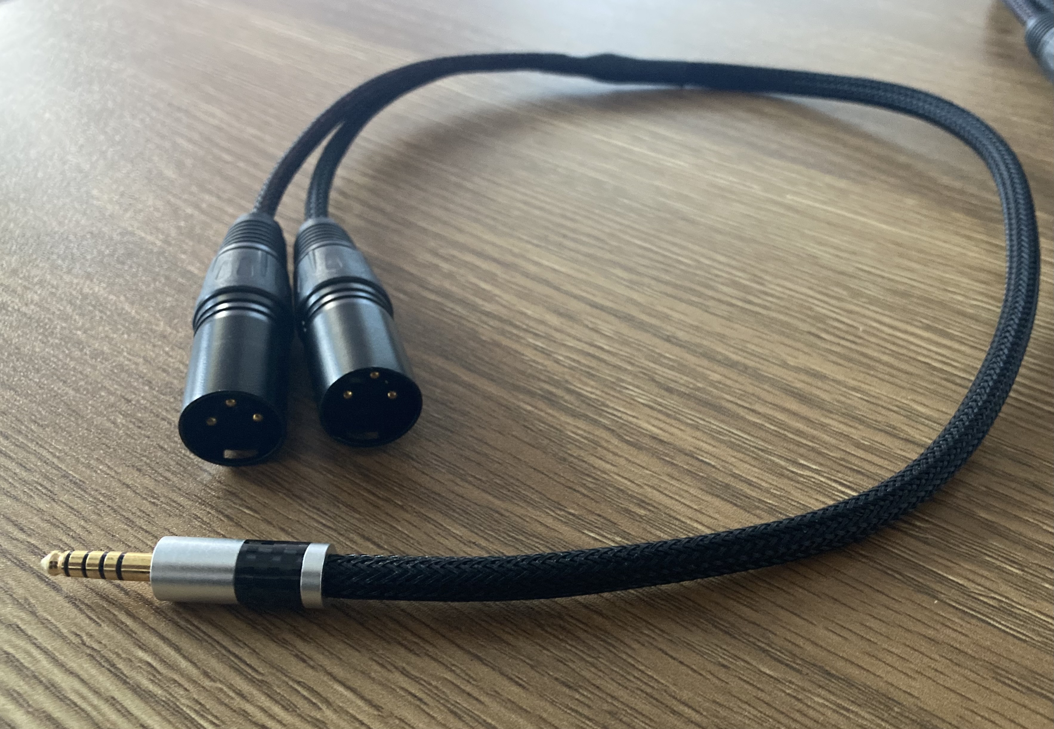

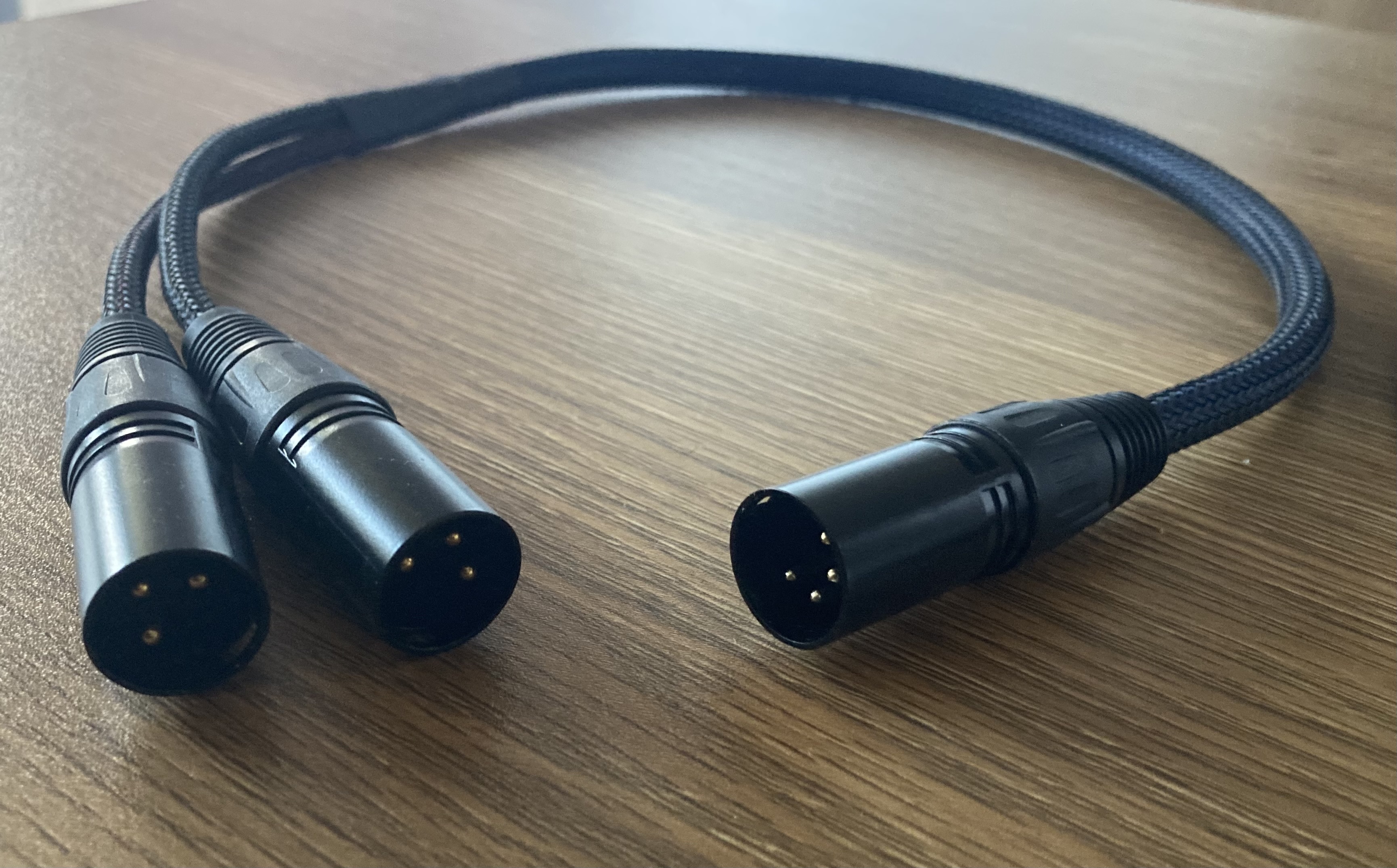

I don’t have measurement adapter cable for the 4-pin XLR nor for the 4.4mm Pentaconn headphone output, so I cannot easily check. I can measure from the unbalanced headphone output, but that is not representative because I don’t use it.

Yeh I got such adapters quite cheap from AliExpress. If they weren’t built correctly, I probably wouldn’t see DAC+Amp output looking like DAC output :slight_smile: , so I am confident they are properly built
Worthy experiment to do especially if discussing sound of amps…

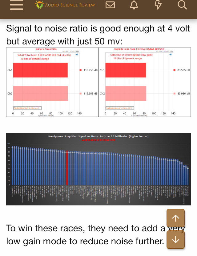

Joutenheim2 has 10dB worse SNR at 50mV, around 83dB
The best headamps are over 90dB at 50mV. Only 1 so far I seen managed 100dB

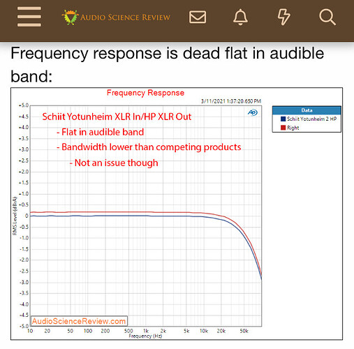

And not a flat frequency response to 100kHz
So this amp may impart its own sound on DAC

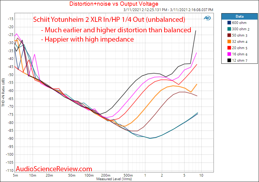

And by the way I today measured my Jotunheim from the unbalanced outputs. And nothing to complain about performance. Especially nice that no change in distortion signatures regardless of switching between different loads.

Here is Joutenheim 2 amp but SINAD is boring
