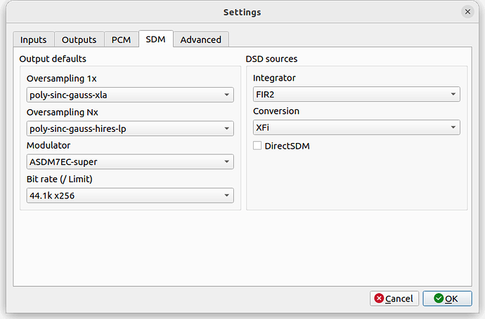

While waiting to buy the Cyan 2 I set the E30II to Fixed Volume, DSD 256, F1 and HQPlayer as follow
Thanks everyone for the help
