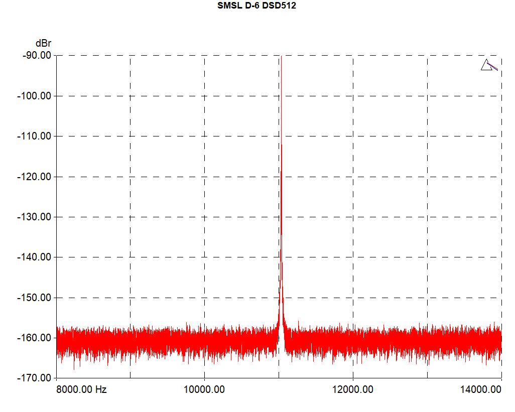

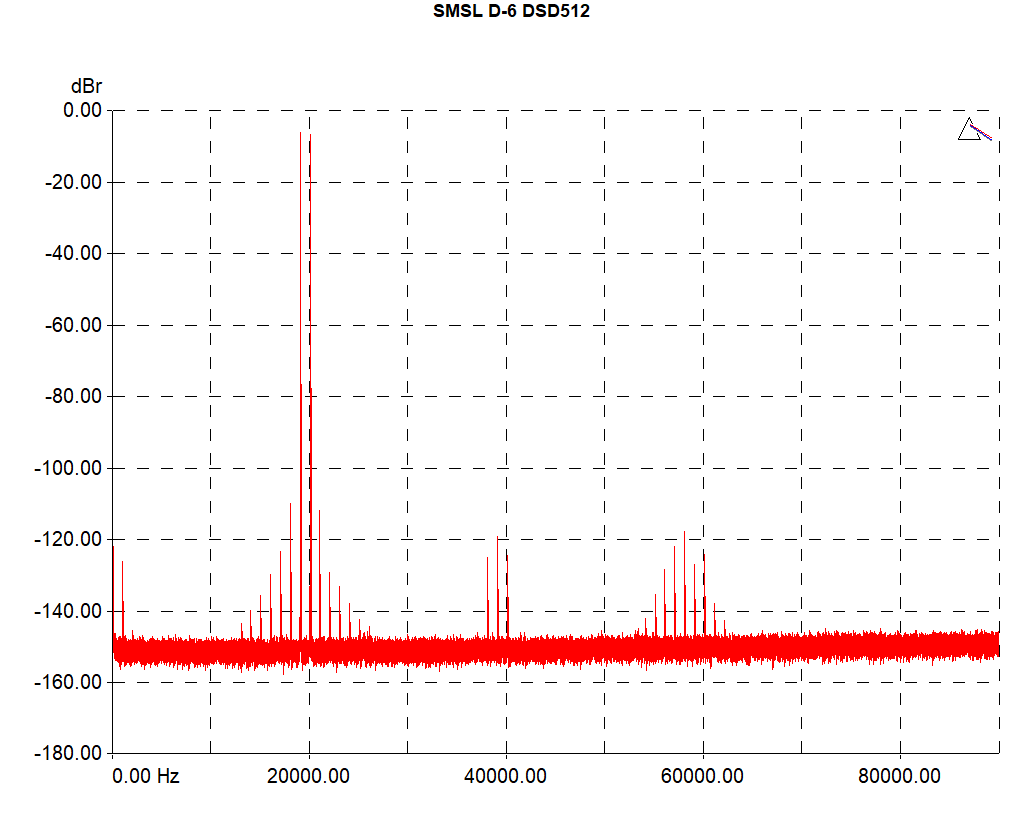

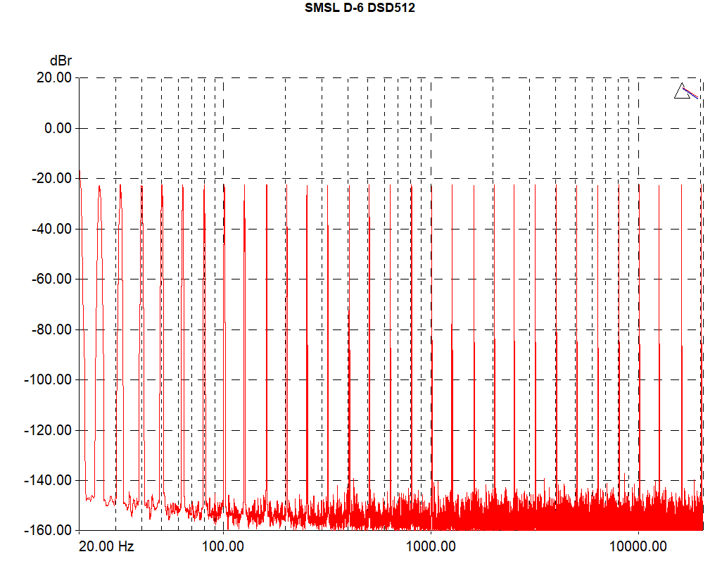

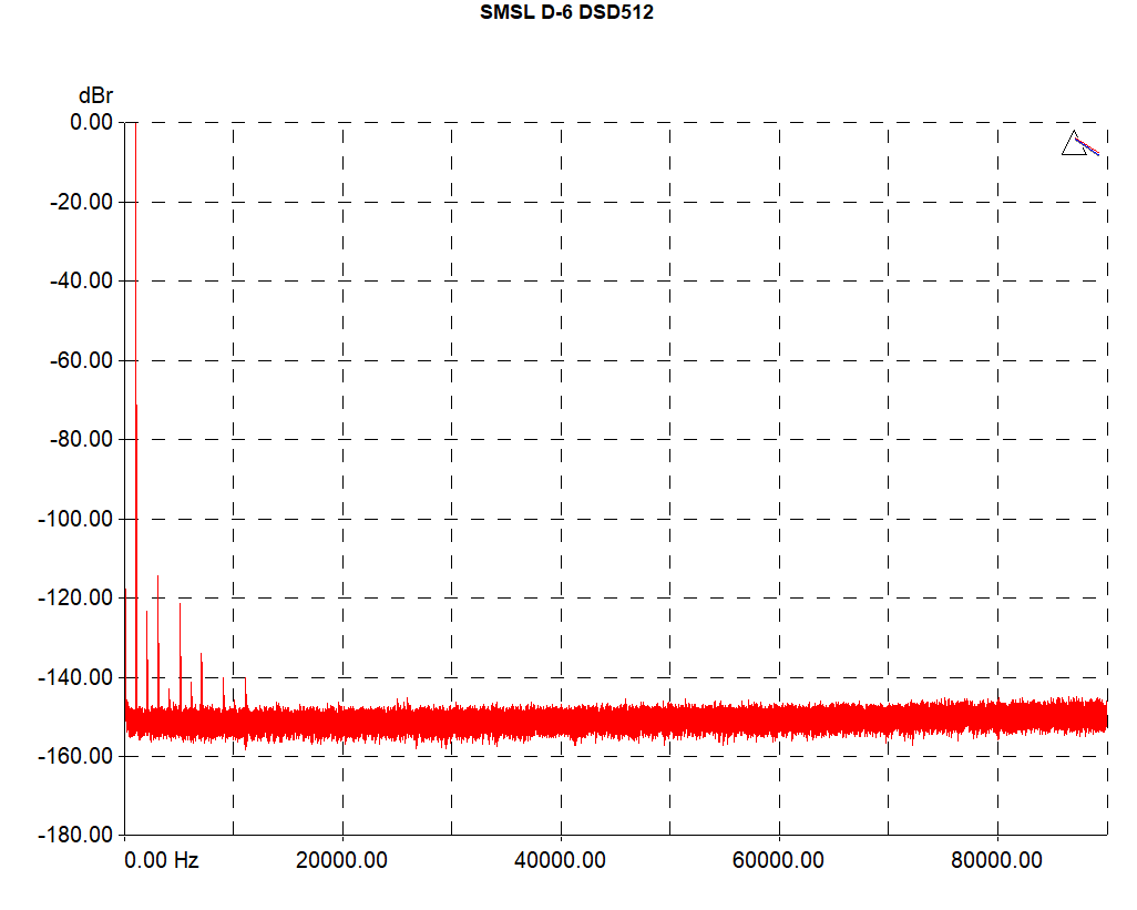

I measured feeding D-6 with DSD256x44.1 and DSD512x44.1k from HQPlayer specifically (gauss-long, EC modulator)

I can confirm D-6 measures well with DSD256x44.1 and DSD512x44.1 from HQPlayer

D-6 passes the tests (if you do all the above mentioned checks)

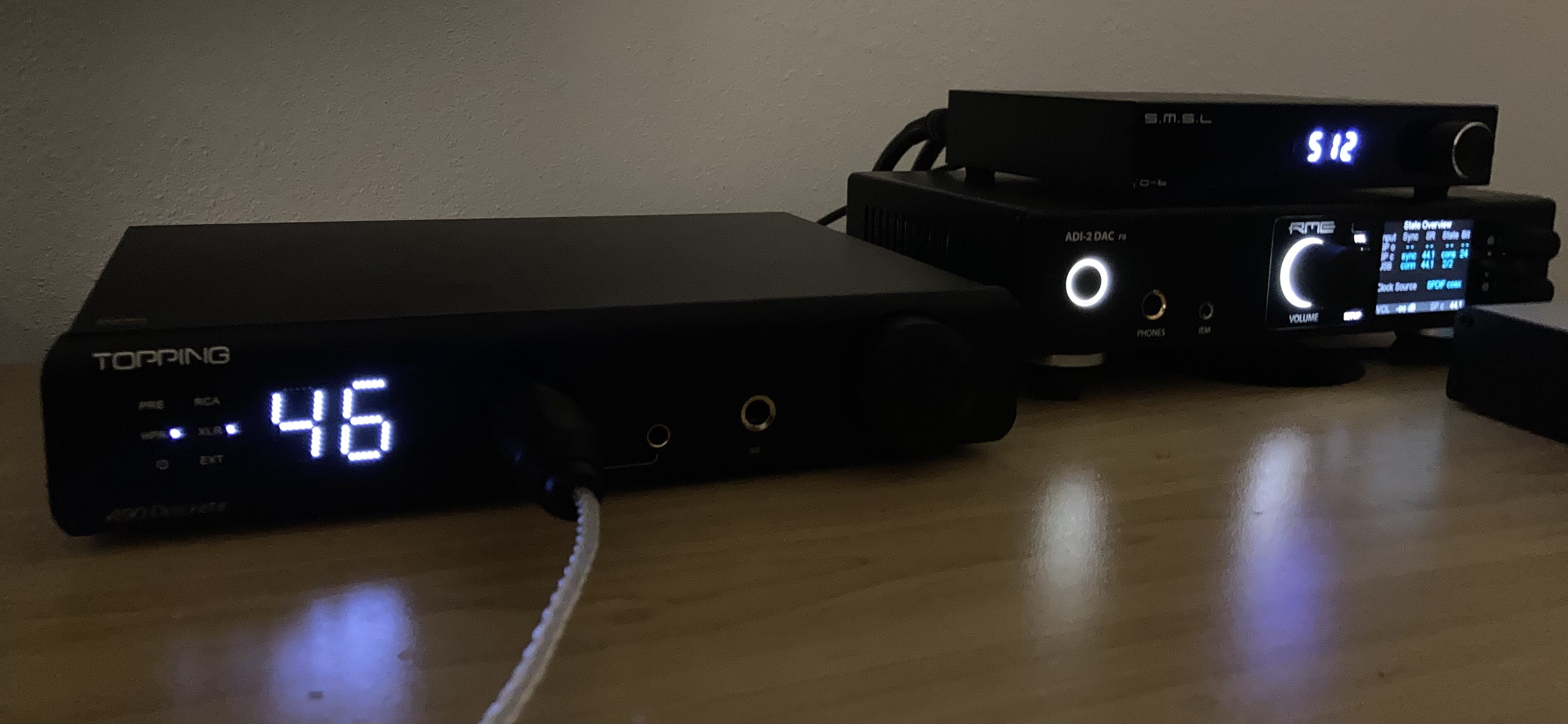

Only one box there is used as a DAC (SMSL D-6).
The RME ADI-2 is only used to feed HQPlayer these days - I feed any TOSlink and digi coax source through HQPlayer.
At the moment playing Apple Music Hi-res bit perfectly through HQPlayer. iPad → USB to digi coax coverter → RME ADI-2 → HQPlayer
And the 3rd box (Topping A90 Discrete) you see is just a dumb analogue headphone amp , no DAC inside :grin: I love the dot matrix display and resistor ladder volume control for perfect channel balance
But I have more DACs in other rooms :crazy_face:
